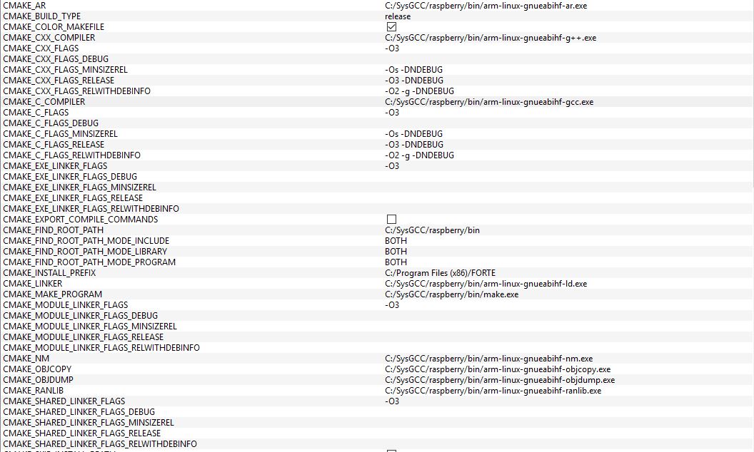

Hi 4Diac Team,
i have a questions about the buildsize from forte as posix.
The size of my build is 10MB now,
i have removed the "-g" entries on C_FLAGS_DEBUG, and add "-O3" on C-FLAGS
My forte buildsize from 9M1 is 1,6MB but with the same CMAKE Values have my 9M2 more then 10MB.
Maybe who has a tip for me what i´m doing wrong.
