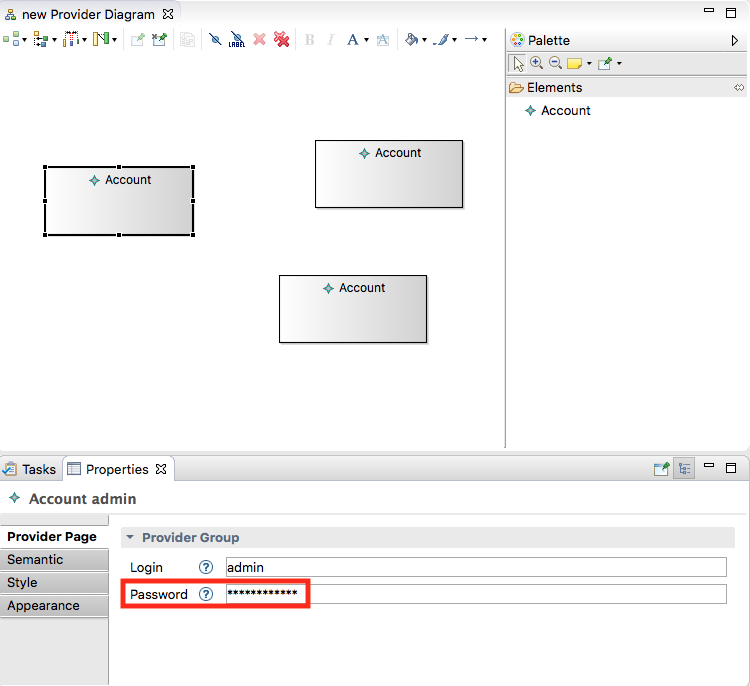

Thank you Florian,

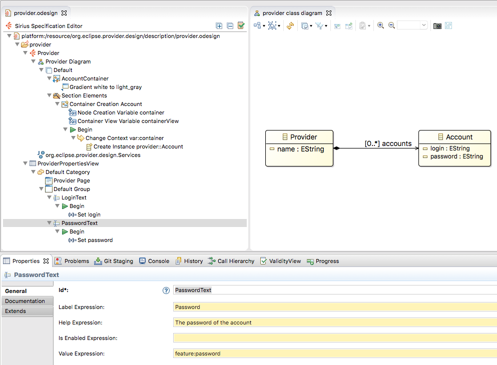

As shown in the following Figure (the right part), I have a metamodel with two classes Provider and Account.
A provider owns a set of accounts and an account has a login and a password.
index.php/fa/31765/0/
The idea is how to hide the content of the password when the user writes it (as expected in the following Figure).
index.php/fa/31766/0/
So, according to the documentation (here https://wiki.eclipse.org/Sirius/Tutorials/PropertiesViewTutorial#Widget_Text), I create a properties view with a group containing two texts, loginText and PasswordText (the left part of the first Figure).
However, I didn't see how can I customize the shown content of the password.
Is it with a style? or with a customized style?
Any idea/suggestion?
Faiez
  • Attachment: password1.png
    (Size: 165.85KB, Downloaded 300 times)
  • Attachment: password2.png
    (Size: 84.79KB, Downloaded 270 times)
