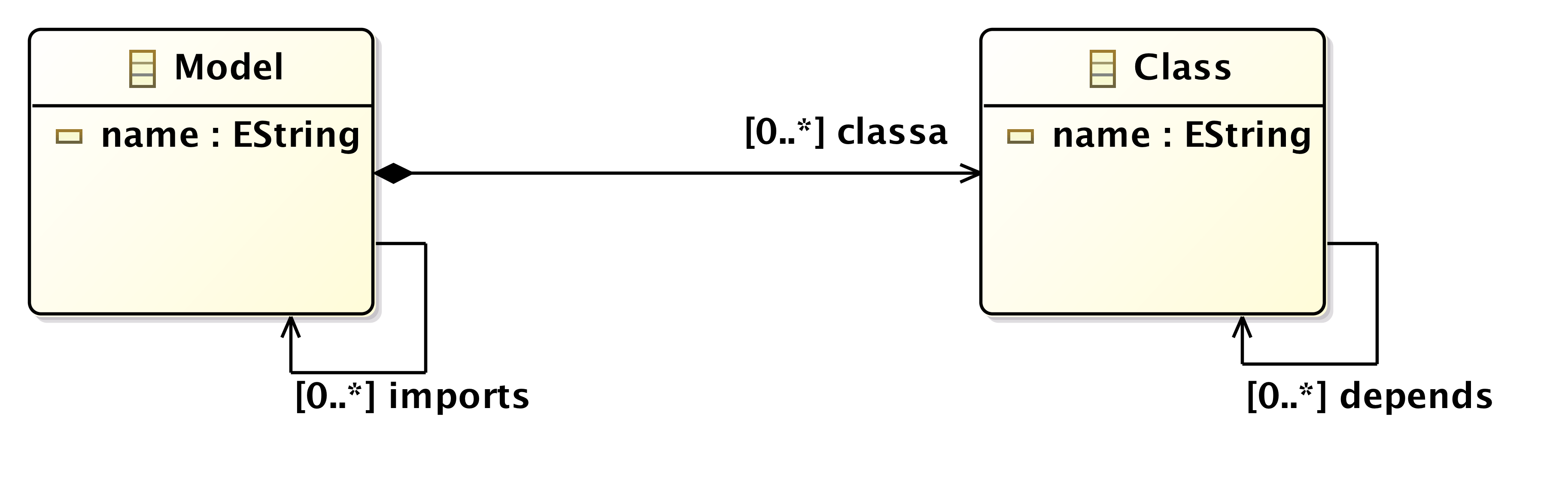

Let us consider this simple metamodel
package test : test = 'http://test/ecore'
class Model
property classa : Class[*|1] { ordered composes };
property imports : Model[*|1] { ordered };
attribute name : String[?];
invariant ClassDependsLocalOrImported: classa.depends->forAll(let model = oclContainer()
in model = self or imports->includes(model));
class Class
property depends : Class[*|1] { ordered };
index.php/fa/31713/0/
The ClassDependsLocalOrImported invariant allows checking that all depended classes must be contained by the current model or imported ones.

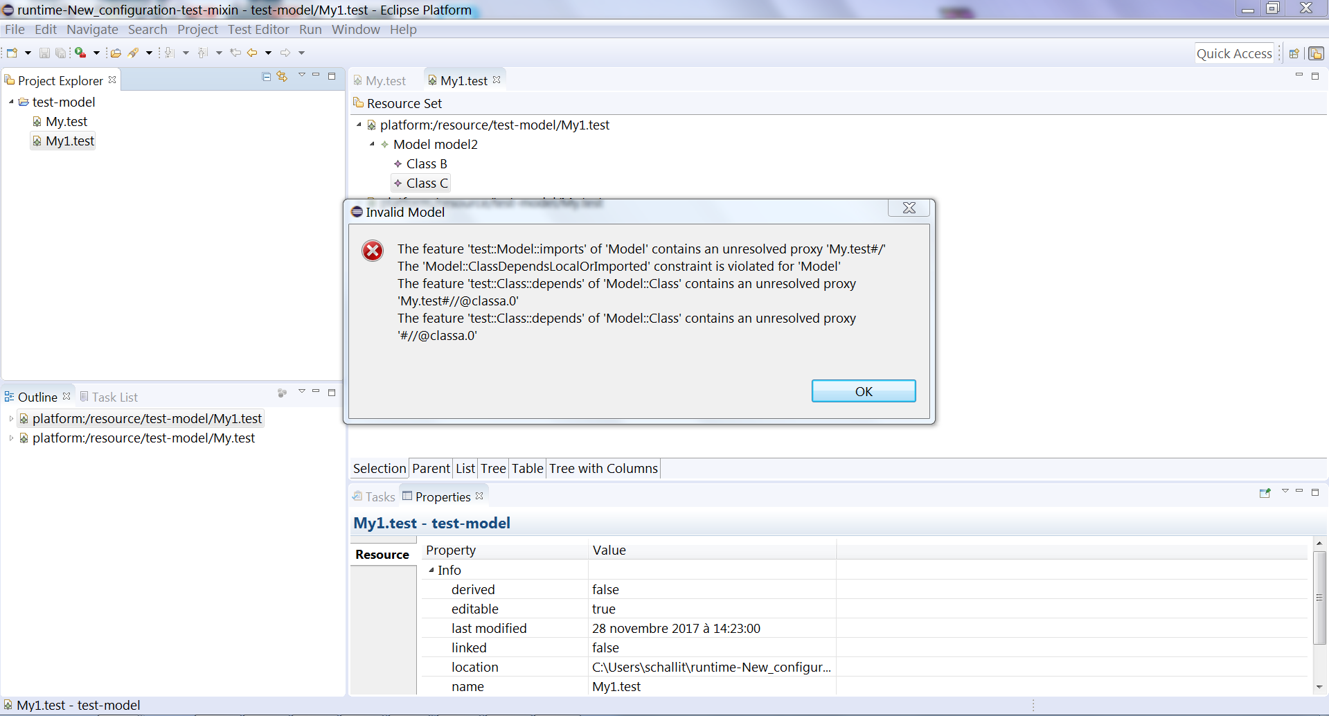

The strange behavior is that the same model, which is valid under a MacOS/Linux, becomes invalid under Windows OS.

When I use a MacOS/Linux machine and I execute my validation code on the model2, the validation passes.
However, with the same model, using a Windows machine, I obtain a validation error as shown in the following.
index.php/fa/31714/0/
Any idea about this behavior?
