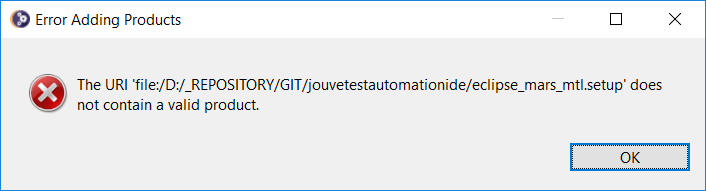

I am trying to load a product setup file with the OOMPH installer, and the error I obtain is : "File .... does not contain a valid product", without any details.
I have try to load this file with OOMPH setup editor directly, and the editor does not provide any errors or warning about its format.
I can not share the product file, because there is a lot of internal repository identified in it.
My question is : how I can obtain more details about Why it is a seen as an invalid product by the OOMPH installer?
Thx for your help!
Tony
  • Attachment: Error.png
    (Size: 10.58KB, Downloaded 232 times)

Given the message you show, it's hitting "product == null" case so the file does not contain a Product. Perhaps it contains a Project? Or something else? What is the first element you see in the XML representation? It should look similar to this:

You are right, the XML file is starting with a Project.
I will dig a bit to find why it is the case and which difference it implies to use it.
