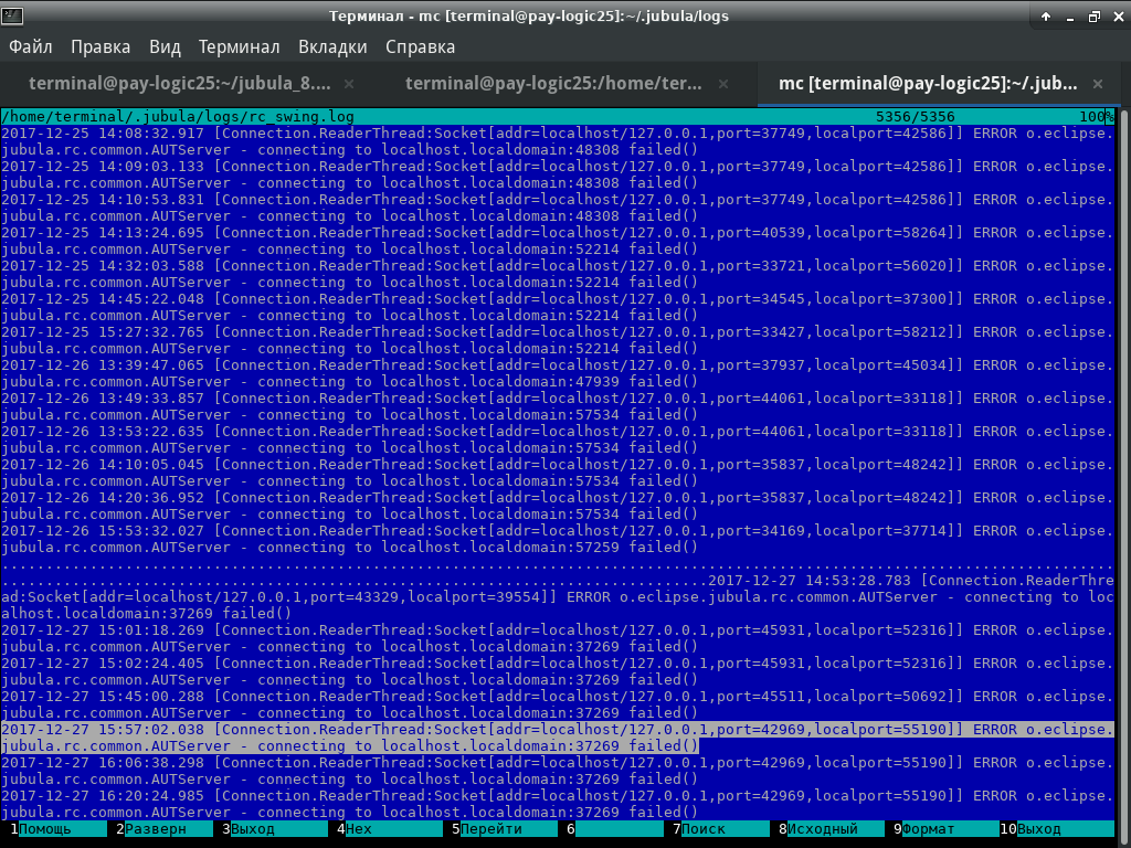

When I start embedded AUTagent, testcase is executing well, but when I'm trying to start this testcase on remote AUTagent, test execution stops at 50%
In ITE I can start and stop SimpleAdder on remote machine, but execution doesn't start. In rc_swing.log I can see
Connecting to localhost.localdomain failed()
It looks like remote AUTagent is trying to connect to localhost instead of my host machine where ITE is started and waiting for test results

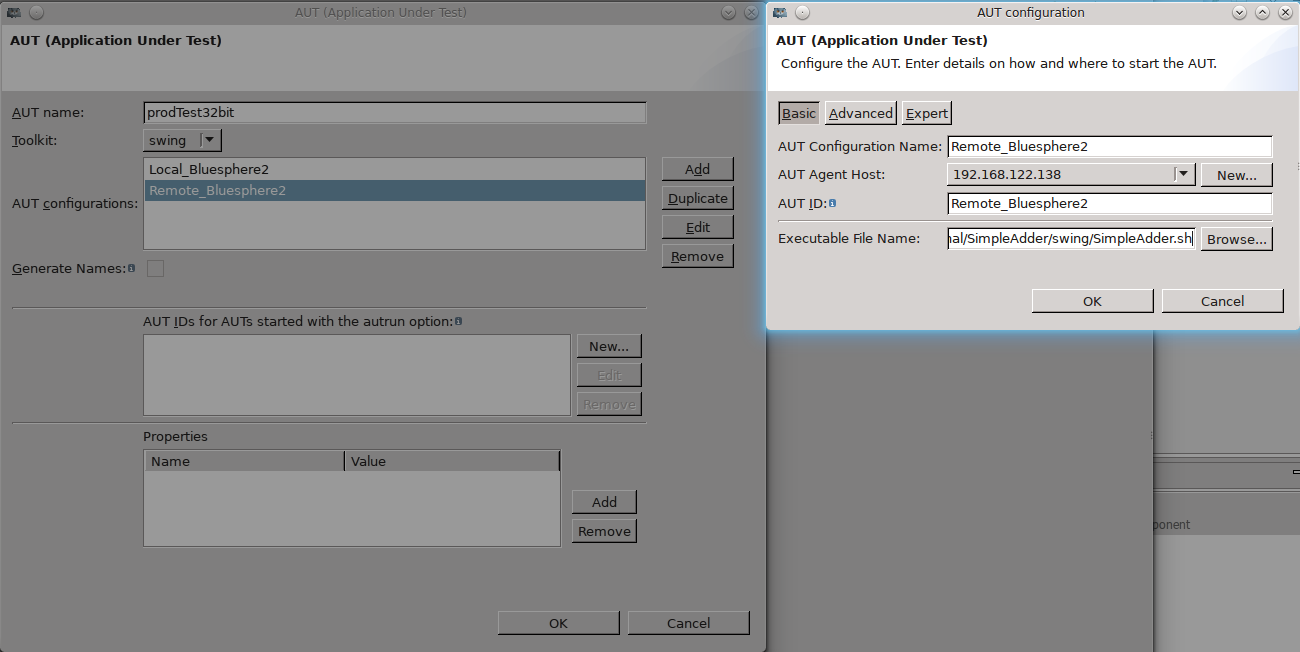

Nothing happens after starting of the test, yes. I can see question marks instead of failed or success test steps
Firewalls are disabled on both machines (I used command systemctl stop firewalld)
Current settings of firewall and results of execution are on screenshot
