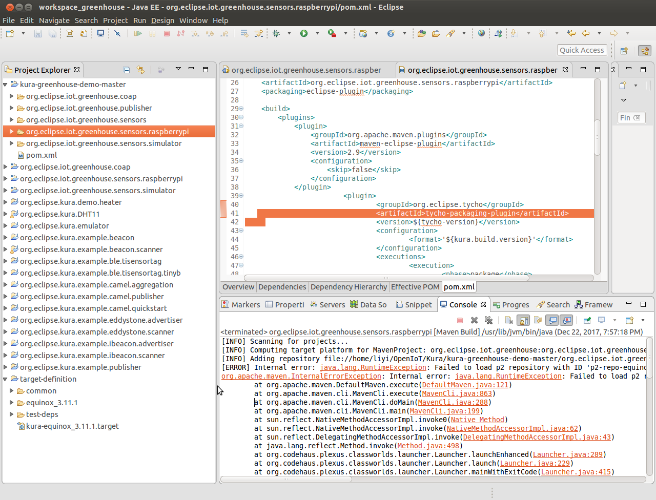

Hi everyone:
There are my steps to build greenhouse project.
1 . Download the source code from github
2. Import the greenhouse project as Maven project.
3. Right-click the project and select the command "Run as"-->Maven build--> Run
4. Got the following problems:
My Environment : Eclipse Neon 3. Eclipse Kura 3.1 ; OS: Ubuntu 12.0; Maven;
Is there anyone who can tell me how to build it? thank you!
Adding repository file://home/liyi/OpenIoT/Kura/kura-greenhouse-demo-master/org.eclipse.iot.greenhouse.sensors.raspberrypi/../kura/kura/target-definition/equinox_3.8.1/repository
[ERROR] Internal error: java.lang.RuntimeException: Failed to load p2 repository with ID 'p2-repo-equinox_3.8.1' from location file:////home/liyi/OpenIoT/Kura/kura-greenhouse-demo-master/org.eclipse.iot.greenhouse.sensors.raspberrypi/../kura/kura/target-definition/equinox_3.8.1/repository/: URI has an authority component -> [Help 1]
org.apache.maven.InternalErrorException: Internal error: java.lang.RuntimeException: Failed to load p2 repository with ID 'p2-repo-equinox_3.8.1' from location file:////home/liyi/OpenIoT/Kura/kura-greenhouse-demo-master/org.eclipse.iot.greenhouse.sensors.raspberrypi/../kura/kura/target-definition/equinox_3.8.1/repository/

Re: How to build greenhouse source code with Marven? [message #1778842 is a reply to message #1778839] Fri, 22 December 2017 06:37 Go to previous messageGo to next message
The attachement is my problems.
  • Attachment: problem.png
    (Size: 271.31KB, Downloaded 190 times)

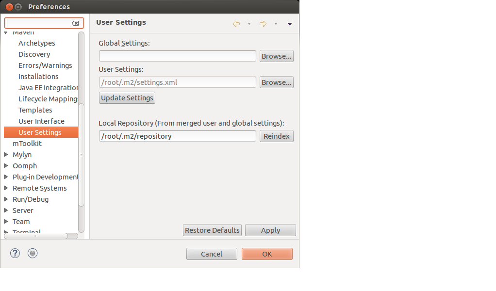

Here is my Eclipse Maven default configure.
  • Attachment: mvnconfig.png
    (Size: 64.33KB, Downloaded 173 times)

I believe the problem is related to the fact that the Greenhouse code works with old versions of Kura (before 3.0.0).
If you want to have it working, I believe you need to download Kura 2.1.0 and try to build again from that point on.
Matteo
