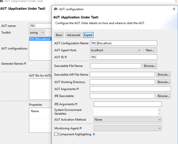

I'm trying to create config for swing application.
There were "Main Class Name" and "Classpath" options in Jubula 8.1 and 8.3, but i don't have them in 8.5.
What do i need to change to get this parameters back?

The option for main class and classpath has been removed.
If you want to use them you have two options:
Either you create a platform dependent script (e.g. bash(linux) or bat(windows))
and have there something like this(e.g. for linux DVDTool ):
java -cp DVDTool.jar org.eclipse.jubula.examples.aut.dvdtool.DVDTool
or you do this in the JRE Arguments parts of the configuration Dialog.

Thank you very much for answer. I tried both versions: bat file and "JRE Arguments". In both cases application is started fine, but Jubula says "Starting AUT with ID:...". So, looks like it doesn't catch that aut has been already started fine.
Could you, please, suggest me what can be wrong?
