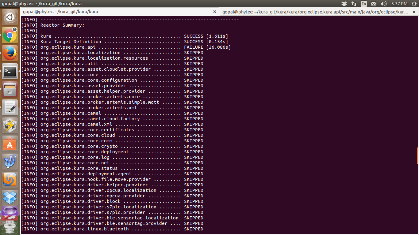

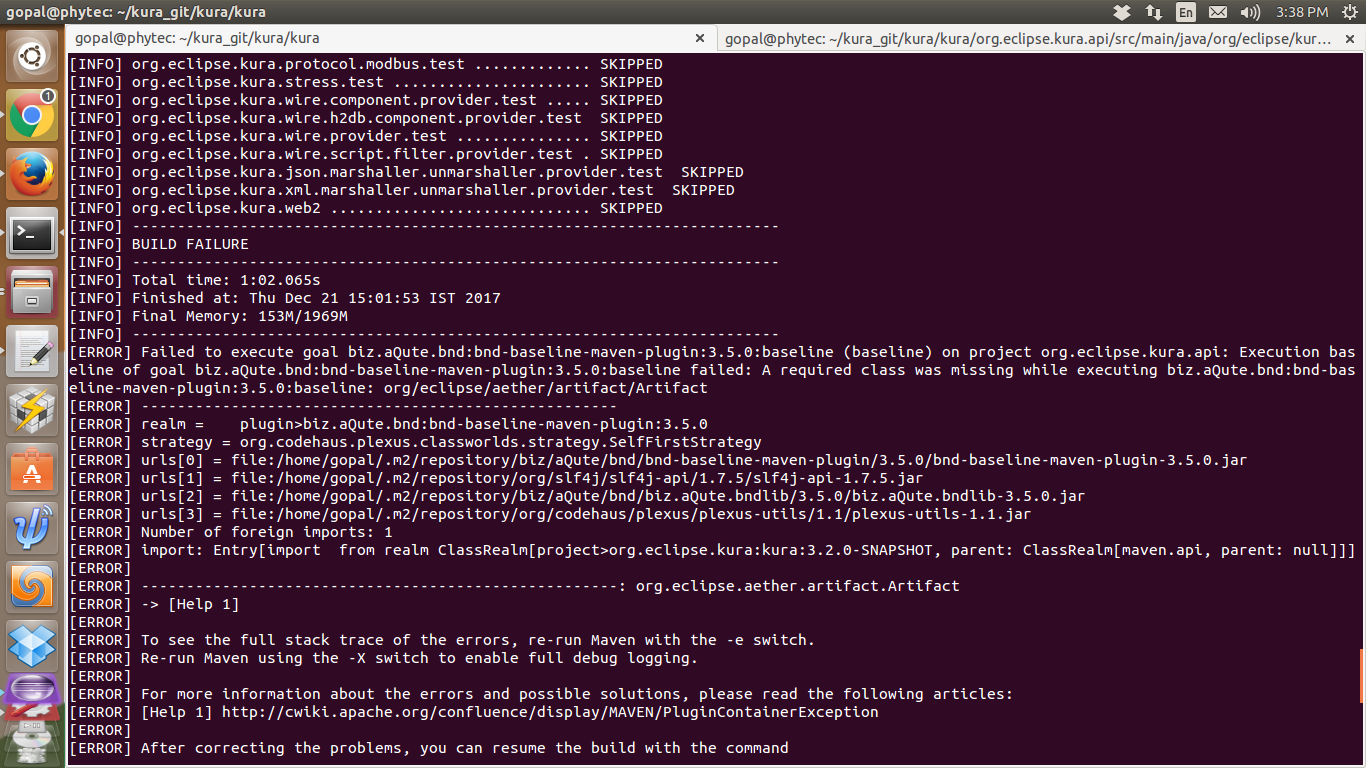

I started building kura by useing the maven
I am Downloaded the kura source from git:- git clone -b develop https://github.com/eclipse/kura.git.
I gave mvn clean install in target-platform it building successfully, after that I start building the core component in /home/gopal/kura_git/kura/kura, here I gave mvn -Dmaven.test.skip=true -f pom.xml clean install. but it showing below errors.please help

Try to update your JDK and Maven, then build again.
