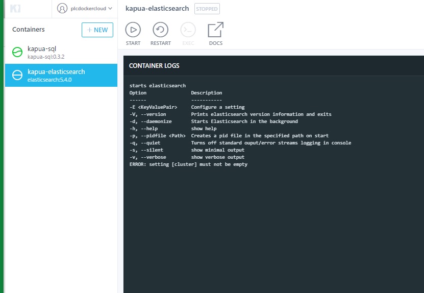

I can't run kapua-elasticsearch
($ docker run -td --name kapua-elasticsearch -p 9200:9200 -p 9300:9300 elasticsearch:5.4.0 -Ecluster.name=kapua-datastore -Ediscovery.type=single-node -Etransport.host=_site_ -Etransport.ping_schedule=-1 -Etransport.tcp.connect_timeout=30s)

  • Attachment: scr1.jpg
    (Size: 63.05KB, Downloaded 250 times)
