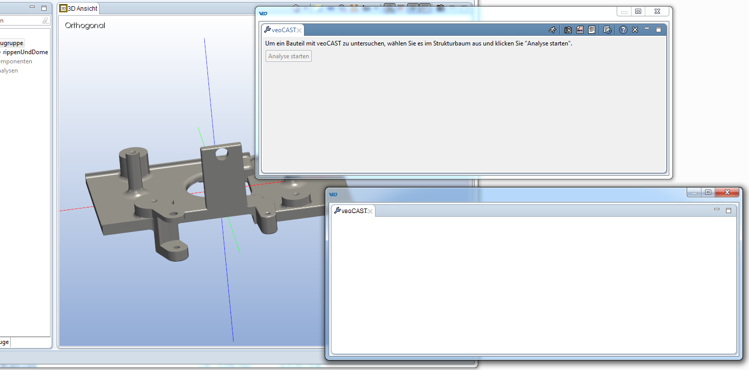

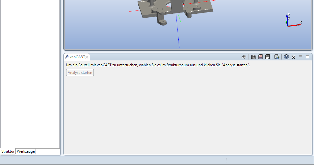

we have a RCP app, based on compatibility layer. We have a major problem with views: The view composite is somehow doubled when the view is dropped out of the mainframe.
I have made two screenshots, one after attacing the view within the frame , one after dropping it out:
index.php/fa/31621/0/
index.php/fa/31622/0/
This happens in Neo and Oxygen. Can anybody give me a hint to a patcvh or a code where I can debug and fix it by myself.

Interesting, I have never seen this before. It may be a perspective initialization problem with folders and placeholderfolders, see your perspective class.
What happens when you press ALT+SHIFT+F1 (plugin spy) on both views?
