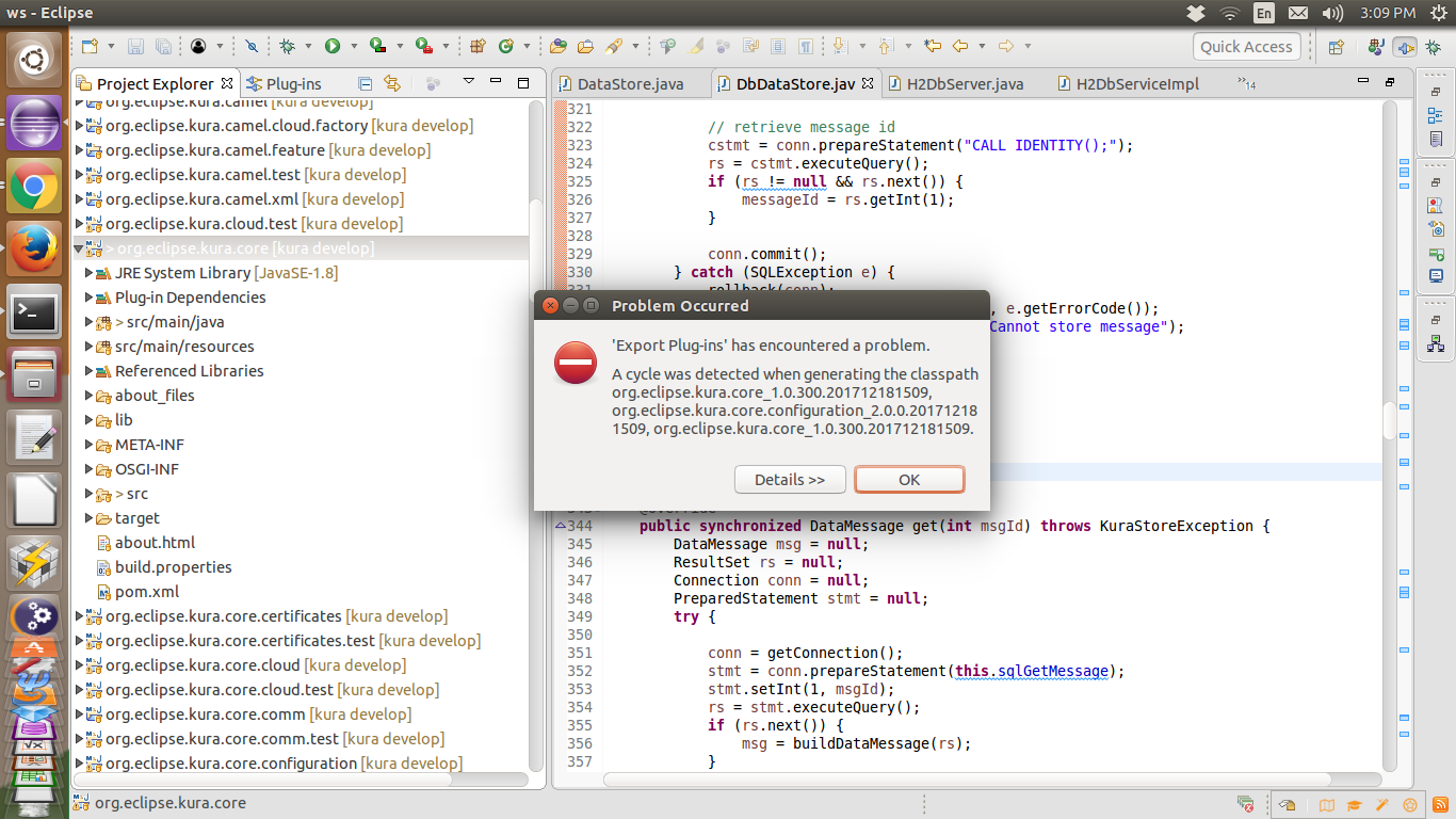

If I did any changes in core , How can I export the core bundle.
Re: core exporting [message #1778581 is a reply to message #1778580] Mon, 18 December 2017 04:43 Go to previous messageGo to next message
I Kept some of the debuging logs in side the org.eclipse.kura.core bunble,I am trying to export the core bundle, I got below error.please help me.

I believe the best way is to build using maven.
Matteo

I Kept some of the debug logs in the org.eclipse.kura.core bunble,I am trying to export the core bundle, I got below error.please help me
