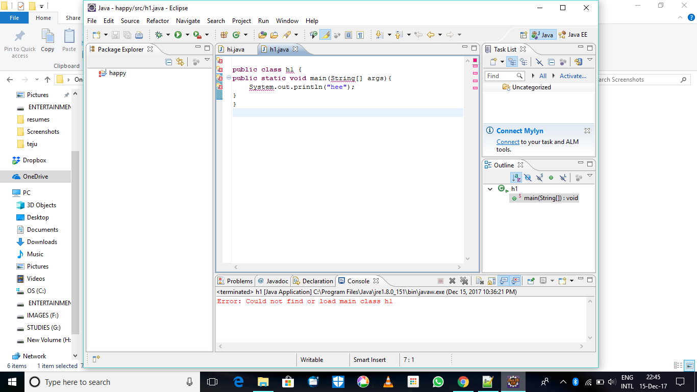

Why I am getting this error please find attached screenshot
Re: !error [message #1778538 is a reply to message #1778525] Sat, 16 December 2017 01:09 Go to previous messageGo to next message
It looks like the classpath of the project is invalid, but you've not shown the Problems view that would show which error messages you have. Make sure that in Windows -> Preferences -> Java -> Installed JREs you have at least one valid JRE available and in the context menu of the project, you can look a the Properties -> Java Build Path to make sure there are no errors.
Re: !error [message #1778539 is a reply to message #1778538] Sat, 16 December 2017 01:25 Go to previous messageGo to next message
And if you're developing in Java, it makes sense to use a full JDK rather than a JRE.
