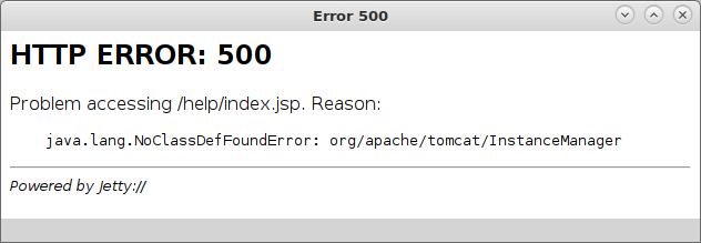

Did a fresh install from the Debian repo package: "eclipse-pydev"
Got Welcome tab showing Overview screen.
When I click on Workbench basics. I get:
HTTP ERROR: 500
Problem accessing /help/index.jsp. Reason:
java.lang.NoClassDefFoundError: org/apache/tomcat/InstanceManager
Powered by jetty://
Tried Help | Check for Updates, and some were done. But after a reboot ran into the same issue again.
It seems that I can't get to any help page, not even from the Help menu.
The single change I made when installing was to specify a new path in /home/howard/eclipse/workspace/ rather than in the default of /home/howard/workspace/ Not sure if that could make any difference or not.
So how do I fix this so I can try eclipse out?
My system: linux 4.9.0-4-amd64, Debian 9.3. / Cinnamon 3.2.7
Re: Fresh install "HTTP ERROR: 500 Problem accessing /help/index.jsp." [message #1778308 is a reply to message #1778304] Tue, 12 December 2017 19:21 Go to previous messageGo to next message
Eclipse.org does not build packages specific to any Linux distribution. Unless something has changed, Debian features a version over 5 years old, and a lack of contributors to bring it up to date or fix packaging problems. You should get a newer version from http://download.eclipse.org , and then install PyDev as a plug-in as documented at http://www.pydev.org/download.html .

Re: Fresh install "HTTP ERROR: 500 Problem accessing /help/index.jsp." [message #1778312 is a reply to message #1778308] Tue, 12 December 2017 20:17 Go to previous messageGo to next message
Thanks. I'll try it. Appreciate the help.
Perhaps someone should just ask Debian to remove it from their repo. I'm seeing:
eclipse
Version: 3.8.1
Build id: debbuild
Also I read here after asking my Q, that eclipse doesn't support openjdk. If that is the case I would think a simple error message would appear at program startup to say that is an issue that needs to be fixed and how to fix it.
Thanks again.
Re: Fresh install "HTTP ERROR: 500 Problem accessing /help/index.jsp." [message #1778314 is a reply to message #1778312] Tue, 12 December 2017 23:28 Go to previous message
On Linux, for the current supported release, it's one of the tested JVMs.
https://www.eclipse.org/projects/project-plan.php?projectid=eclipse#target_environments
Personally, I'd hope that a fan of Debian could dedicate the time to update their package, and keep it updated. Even if that meant just adapting the techniques Fedora uses.
