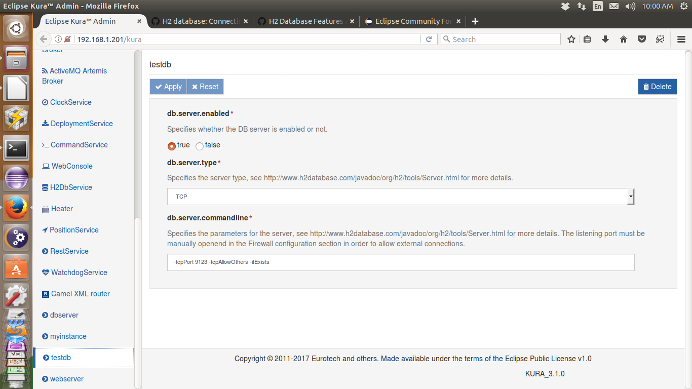

If I understand correctly, you are trying to open the H2 web console using your browser, but your H2DbServer instance is configured for JDBC (TCP type), if this is the case the H2DbServer instance must be reconfigured as follows:
- db.server.type: WEB
- db.server.commandline: -webPort 9123 -webAllowOthers -ifExists
then you should be able open the web console, provided that port 9123 is open in the firewall configuration section.

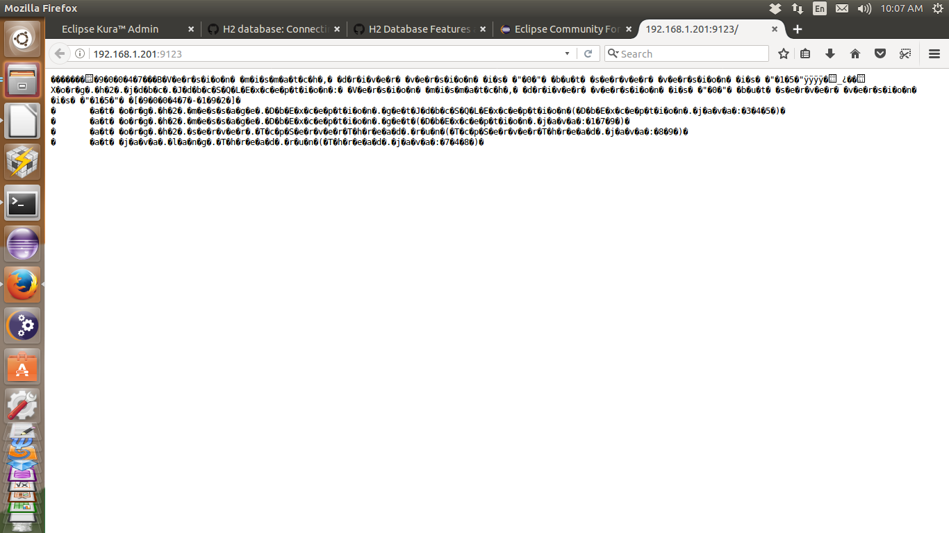

Re: persistance in kura [message #1778252 is a reply to message #1778246] Tue, 12 December 2017 05:29 Go to previous messageGo to next message
I followed the what ever you given link. but web part I unable to open.
https://www.dropbox.com/personal?preview=port.png

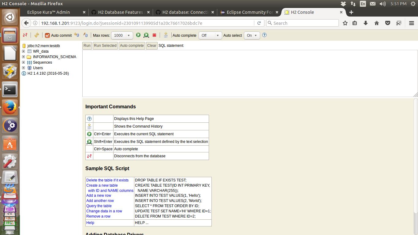

Re: persistance in kura [message #1778263 is a reply to message #1778252] Tue, 12 December 2017 07:22 Go to previous messageGo to next message
thanks a lot for giving the link.

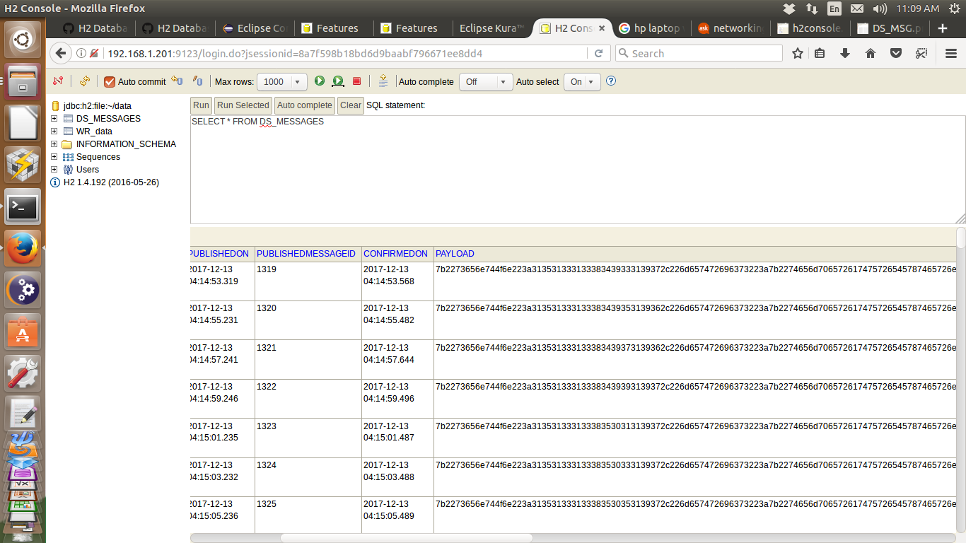

I sucessfully opened the webpart. there how can I see the data what ever I send through demo heater bundle.in these I gave (jdbc:h2:mem:testdb),what is the diffrence between the (jdbc:h2:mem:testdb) and (jdbc:h2:file:~/data) here (testdb) and (data) is just files I created inside my board home path. please tell me.

Re: persistance in kura [message #1778268 is a reply to message #1778263] Tue, 12 December 2017 08:23 Go to previous messageGo to next message
For viewing the data published by the heater demo, you need to enter in the Web console the db url of the instance used by the DataService, in this case you should be able to find the data inside the "DS_MESSAGES" table.
In the default configuration, this instance is automatically created, and it has the "H2DbService" kura service pid, (you should see it under Services in the web ui) and its db url should be "jdbc:h2:mem:kuradb". By entering this last URL in the Web console you should be able to see the heater data.
If use the "jdbc:h2:mem" URI you are creating an in-memory (RAM) database instance, that is not persisted on the device storage, so there are no files involved.
In-memory dbs are quite fast and do not wear out flash storage, but all data contained in them is lost when Kura is restarted, the db instance is deleted, or if you change the URL of the db instance to something different.
You can use this for non-critical temporary data that is frequently updated, and it is the default for the Data Service db.
Using the "jdbc:h2:file" URI you get a persistent database instance, that uses a regular file for storing the data.
In this case the data is retained as long as the backing file exists, you can append different parameters to the url string for tuning the db performance and reliability.
You can find more details about the db URIs at the end of the guide I've posted above and in the official H2 documentation, for example here:

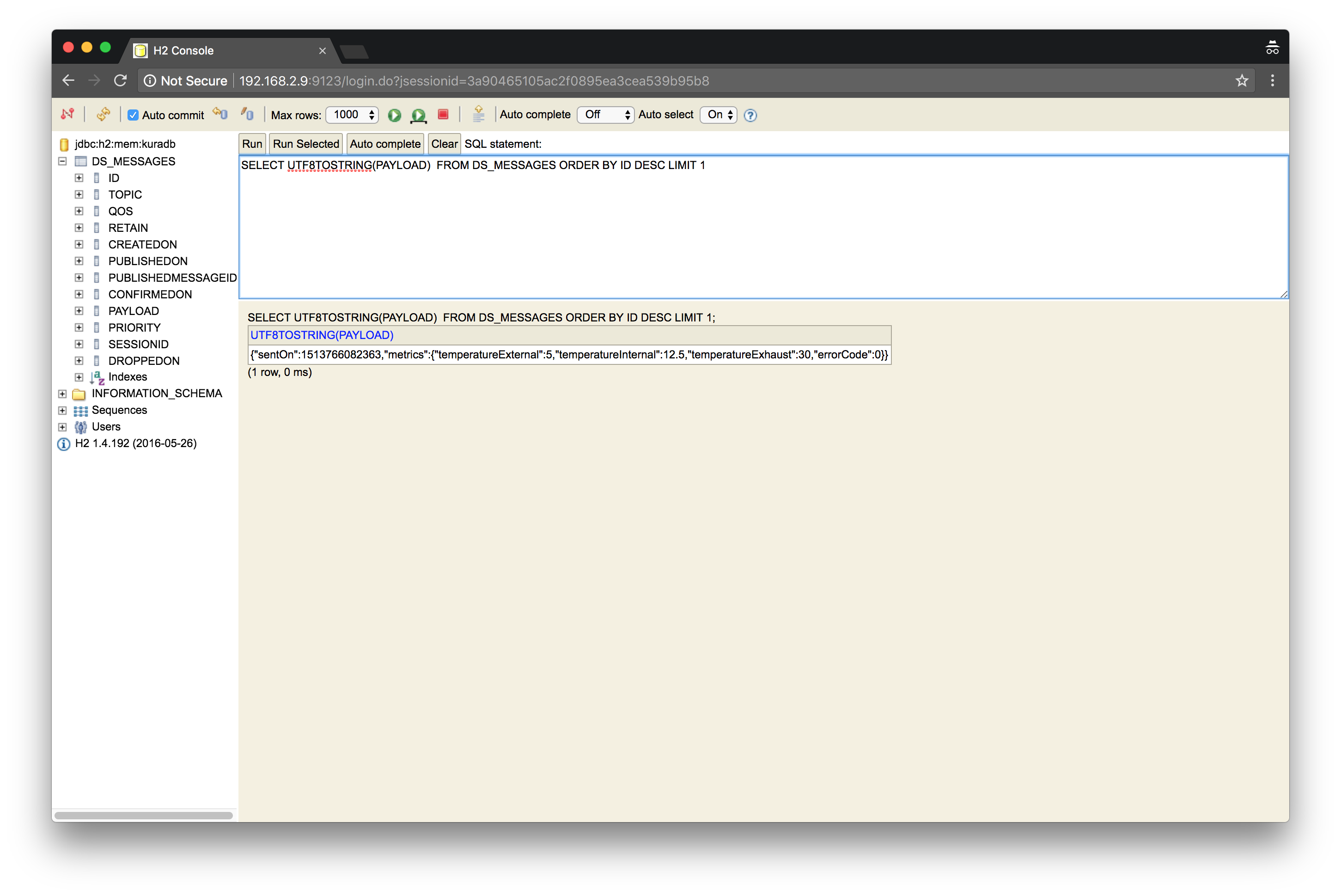

Re: persistance in kura [message #1778572 is a reply to message #1778571] Mon, 18 December 2017 00:03 Go to previous messageGo to next message
How can I get the Exact data in payload in H2 console.Please help me
Re: persistance in kura [message #1778703 is a reply to message #1778572] Wed, 20 December 2017 05:38 Go to previous messageGo to next message
You can try the query in the attached screen
  • Attachment: query.png
    (Size: 375.53KB, Downloaded 287 times)
Re: persistance in kura [message #1778710 is a reply to message #1778703] Wed, 20 December 2017 06:17 Go to previous message
thanks for your support, now am acquiring according to my requirement.
