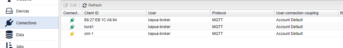

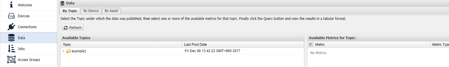

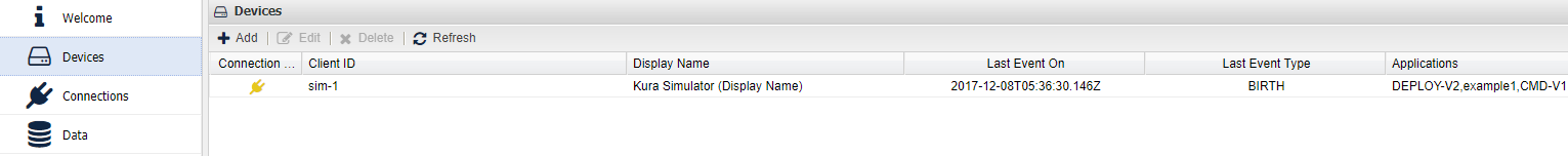

I use the kapua as cloudservice and connect kura. Then install the org.eclipse.kura.demo.heater to the kura. Erverything is OK, the kura log show the publish message is confirmed .But in the kapua console i cannot see the publish data .I am sure the kapua can receive data .What's the problem?Where is the publish data?
I can see my device in the Connections tab,but i cannot see it in the Devices tab and have not data in the Data tab.(the disconnect device is simulator-kura and example1 topic is simulator-kura generate)

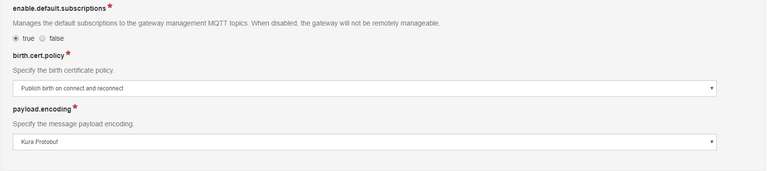

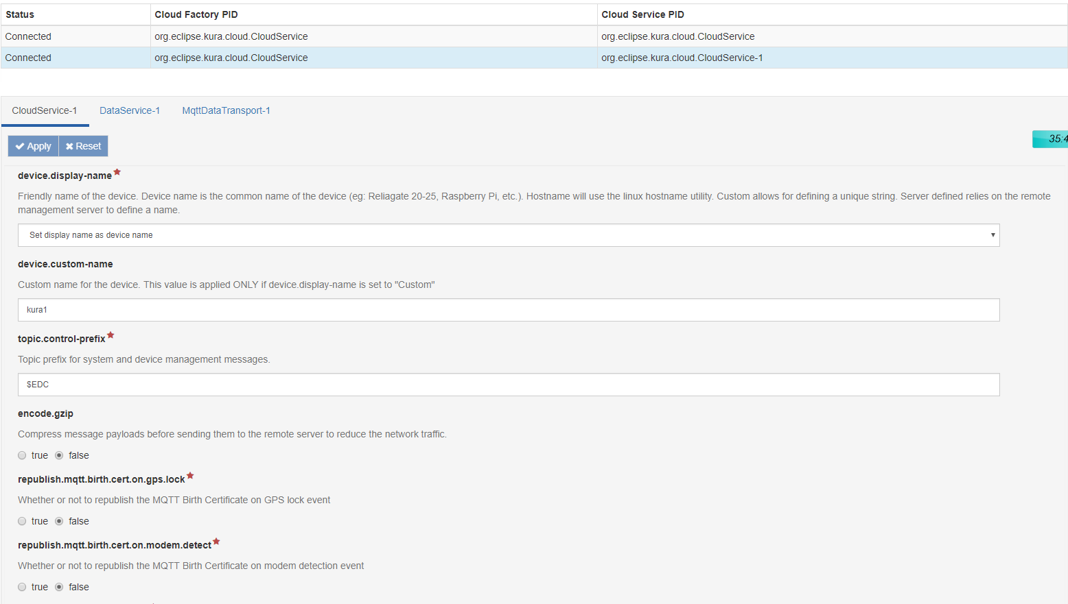

Can you show us your Kura CloudService setup?

Re: Cannot get data from kapua [message #1778311 is a reply to message #1778257] Tue, 12 December 2017 19:55 Go to previous messageGo to next message
Milan Ggg wrote on Tue, 12 December 2017 11:35
index.php/fa/31583/0/
index.php/fa/31584/0/
