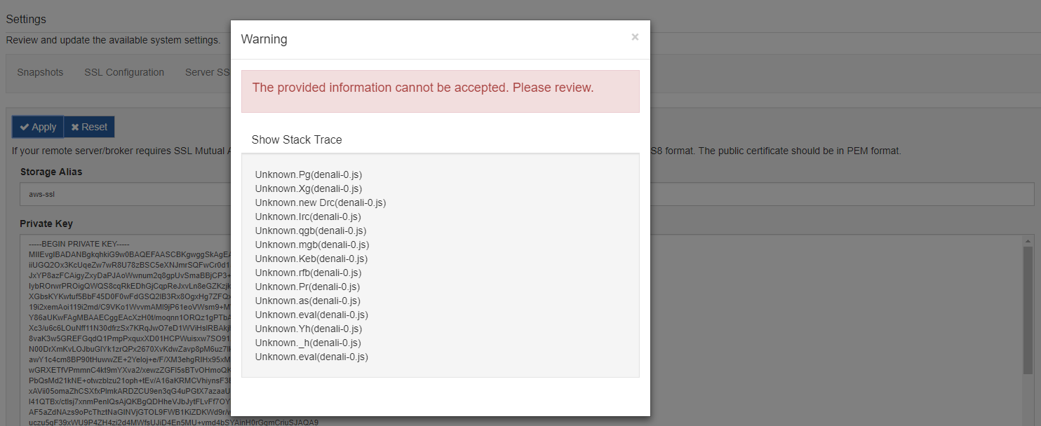

Tried to set Cloud Services using aws iot.
However, I tried to set ssl cert in Kura UI Settings->Device SSL Certificate, after press "Apply", I got an error as attachment.
There is nothing in /var/log/kura-console.log.
Does anyone have ideas what's the problem?
Re: Issue about set aws cloud services [message #1778289 is a reply to message #1778206] Tue, 12 December 2017 11:29 Go to previous messageGo to next message
This error typically occurs when the private key is not in the format expected by Kura. Did you run this command from the documentation:
openssl pkcs8 -topk8 -inform PEM -outform PEM -in xxxxxxxxxx-private.pem.key -out outKey.pem -nocrypt
Re: Issue about set aws cloud services [message #1778290 is a reply to message #1778289] Tue, 12 December 2017 11:41 Go to previous message
adding to what correctly said by Dave: is the keystore properly referenced in the SSL page?
Matteo
