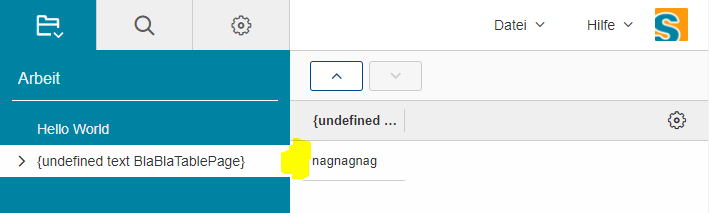

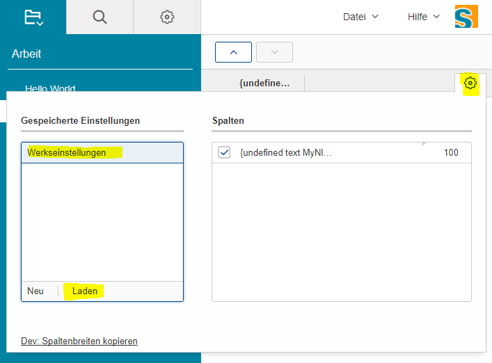

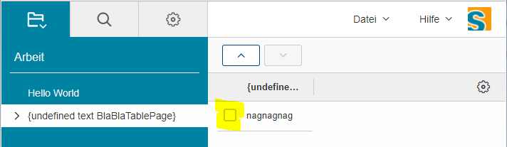

When using Scout v6.1.0.B013, the checkbox of a checkable Table disappears as soon as the default column settings are loaded (see the screenshots). It will only reappear if the user logs out/in.
