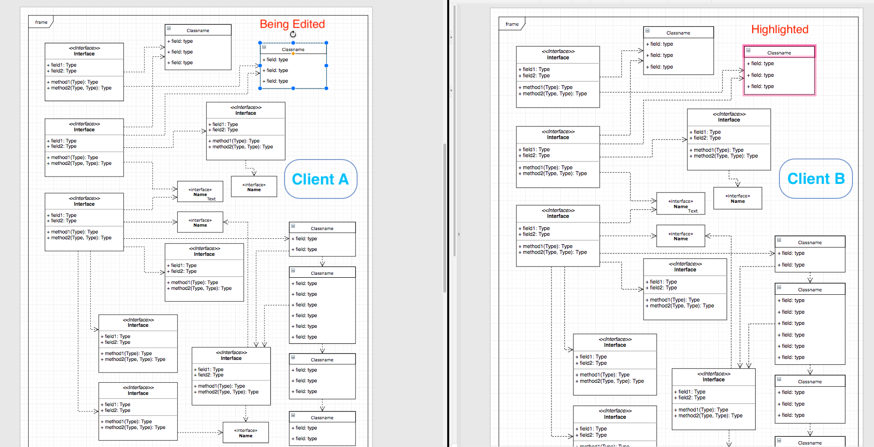

1] Similar to Early Conflict Detection, Notifying the other collaborators about the model element one is currently working on. I mean to say, if three clients Client A, B and C are collaborating, if the particular model element that Client A is currently editing gets highlighted on both Client B and C, it's more like an early alarm and they would be warned to not edit/delete it to avoid conflicts.
As far as I know, if and only if a commit is made, the other collaborators are notified about it (which is the case of Early Conflict Detection). But, something like 'Google Docs' or 'Draw.io' where the element (which currently gets edited) being highlighted would be a cool addition. I have attached an image (Query1.png) which illustrates the functionality I described above for your reference.
Is there any way this could be implemented? Can you please provide me with some pointers on the same?

1] I understand that Lock Notification is already supported. I did try it out using the CDO UI explorer you shipped. However, we decided not to use Locking techniques in our application which is exactly why I wanted to know more about notifying the other collaborators on which model element one is currently working on. The .png file I attached would clearly explain what functionality I am expecting.

Sorry, I missed that picture. The CDO server just sees (explicit) locks and commits, so, what you have in mind is not possible out of the box. But you could use a combination of CDOTransactionHandler and a custom remote message protocol, like so:
