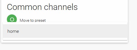

In PaperUI it looks like:
because of the default channel definition in my thing.xml.
index.php/fa/33201/0/

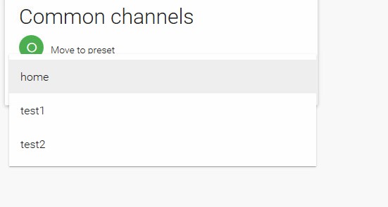

I want that the presets are dynamic loaded from a server:
index.php/fa/33202/0/
How can I change the options at runtime? Can you give me a simple example?
  • Attachment: preset1.jpg
    (Size: 12.34KB, Downloaded 354 times)
  • Attachment: preset2.jpg
    (Size: 13.85KB, Downloaded 387 times)

In the meantime I found a solution. I used a DynamicStateDescriptionProvider. For all who are interested
-> that's my implementation: https://github.com/nibi79/synologysurveillancestation/blob/master/src/main/java/org/openhab/binding/synologysurveillancestation/internal/discovery/SynoDynamicStateDescriptionProvider.java
Thanks again!
