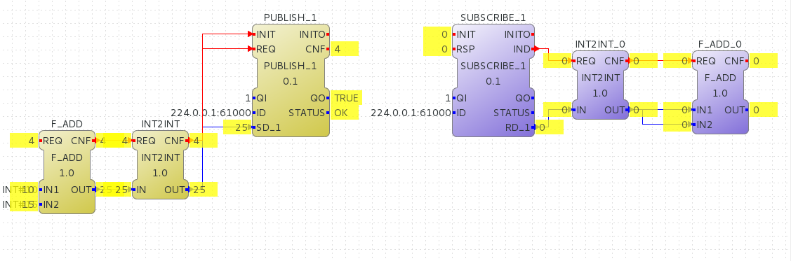

I am trying to run through a simple publisher/subscriber example. I have deployed two instances of FORTE on a single but remote raspberry pi. Publisher and subscriber IDs are the same i.e. a multicast address and a port. Although FBs deployed on both FORTE instances run fine but they do not seem to be communicating. I have check that multicast is enabled on the ethernet interface. I have also checked through tcpdump that no multicast packets get transferred when I trigger REQ. The result of which no data gets transferred between publisher and subscriber. Attached is the configuration of my simple application deployed on separate FORTE instances on the remote raspberry pi.
Am I missing something? Any help would be appreciated.
  • Attachment: pubsub.png
    (Size: 85.35KB, Downloaded 173 times)

Hi, it also looks that you are not correctly initializing your fbs. Especially the Subscriber has not got any initialization event. Maybe that is the issue. On the Publisher side I don't see where the init event is coming from. But it is in general not a good idea to do it in the same way as the REQ. The better setup is to do initialization separate to the control flow.

I have been able to make my solution work after adding a route in raspberry pi and also initializing pub and sub separately as advised by Alois. Thanks a lot for the help.
