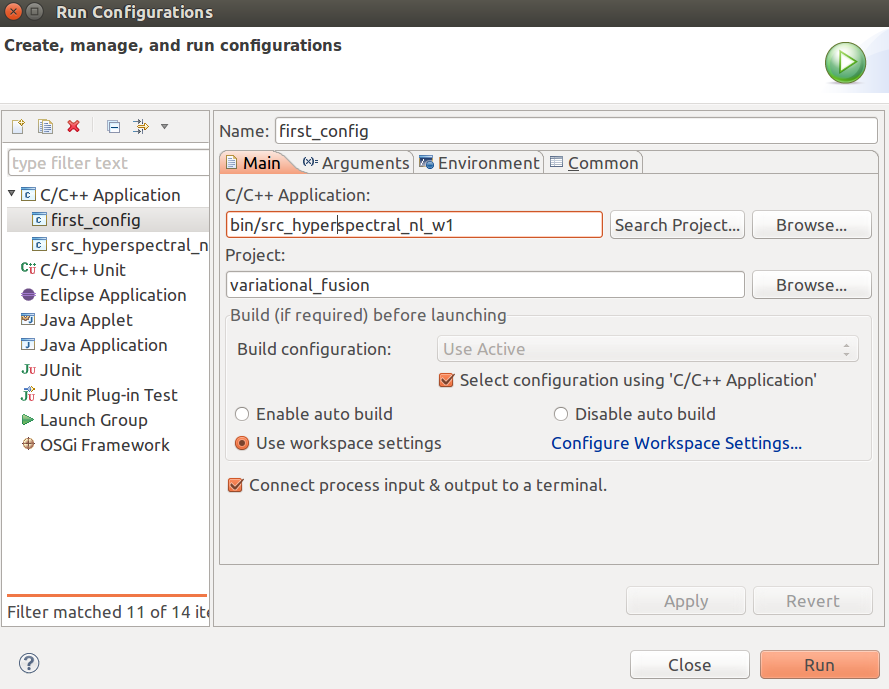

I would like to do image processing in C++ in eclipse and I wanted to test a simple code on a data of type .tif. My image name is "V.tif", I declared it in the argument configuration (see joint image: config_argument). Here's my code:
int main(int argc, char **argv)
	for(int i=0;i<100;i++)
		printf("V[%d] is %.5g \n",i,V[i]);
    return 0;
and here are the errors that I have:
make all
g++ -c    weights.cpp -o weights.o -g -O3 -funroll-loops -fomit-frame-pointer  -ffast-math -ftree-vectorize     -Wall -Wextra  -Wno-write-strings  -Wno-deprecated -fopenmp  -I/usr/local/include/
weights.cpp: Dans la fonction 'int main(int, char**)':
weights.cpp:110:31: erreur: 'V' was not declared in this scope
weights.cpp: At global scope:
weights.cpp:102:5: attention : unused parameter 'argc' [-Wunused-parameter]
weights.cpp:102:5: attention : unused parameter 'argv' [-Wunused-parameter]
make: *** [weights.o] Erreur 1
Makefile:25 : la recette pour la cible « weights.o » a échouée
So according to the error "V" is not recognized, should I change the format of "V"? Is there something else to do in terms of configuration of the argument line ?
Thanks in advance for your help.
-J

V.tif is the name of a file. '.tif' is a common ending of a particular image file name but can mean anything.
V[i] is an element of an array in your program which you need to define.
Two different things called 'V'.
The compiler knows nothing about the runtime arguments of the program.
You need to somehow get the contents of V.tif into your program to manipulate them.
You need to tell your program how to do this.
The compiler doesn't know what you are trying to do.
It's all up to you.
