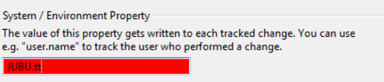

we have activated the tracking. Unfortunately, the Jububla_UserId is displayed in red
index.php/fa/31424/0/
and if a change occurs - this error message appears('Your current signature is invalid. You have to use a valid system property or leave the field empty'):
index.php/fa/31425/0/
index.php/fa/31426/0/
How change it?
Thx

Hello Thomas,
You must specifiy valid System or environment properties like described in the Java documentation[1].
We are trying to verify if these value exist. E.g. user.name should work to use the username of the currently logged in account.
with regards
Marvin
[1] https://docs.oracle.com/javase/tutorial/essential/environment/sysprop.html
