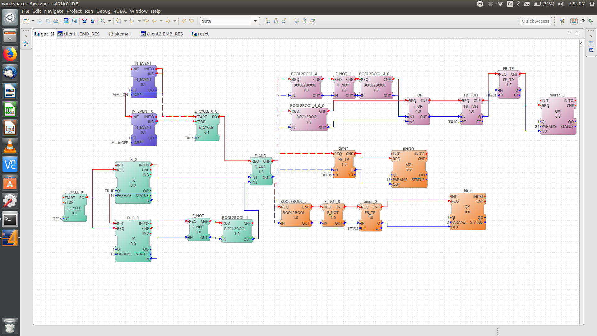

Re: Powerlink And IEC61499 FB [message #1783460 is a reply to message #1782741] Tue, 13 March 2018 06:55 Go to previous messageGo to next message
Dear Mr.Alois
I use 1.8.4 forte version, by the way My Undergraduate thesis looks for an analysis effect of difference of fb architecture to value of quality of services, its means that i make any program who have a different architecture like star, line and etc ( topology) , . I use OPC UA communication protocol,
I will ask, how to refresh the value running on the timer, both timer on and time period? because i have some inputs when the program is running.
the scheme I use is the automotive industry that wants the flexibility of products like car body color in indystry 4.0 era. therefore I should be able to run a program that can enter two inputs while running and eliminate the previous data.
Re: Powerlink And IEC61499 FB [message #1783461 is a reply to message #1783460] Tue, 13 March 2018 07:04 Go to previous message
Actually i have problems again, when i try run this programs, at QX output "merah_0" has "TRUE" value in client, and i try to connect with raspi, but at gpio raspi can't switch on the lamp.
I use opc ua client and server to communicate all of them.
