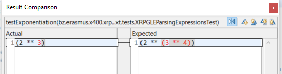

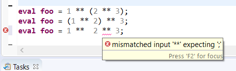

I am strugging to parse an exponent expression.
My issue is that the "nested" exponent expression is not being parsed.
Please refer to the attached screenshots for detail.
Request:
What changes do I need to make to the grammer (below) to be able to parse the nested exponent expression?

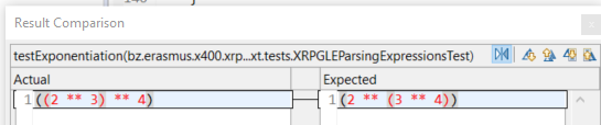

Changed the "?" to "*" now it does parse the expression but the nesting is in the wrong order ( refer attached screenshot). I need to change the "association" from left to right, but I am unsure how to. Can you advise?

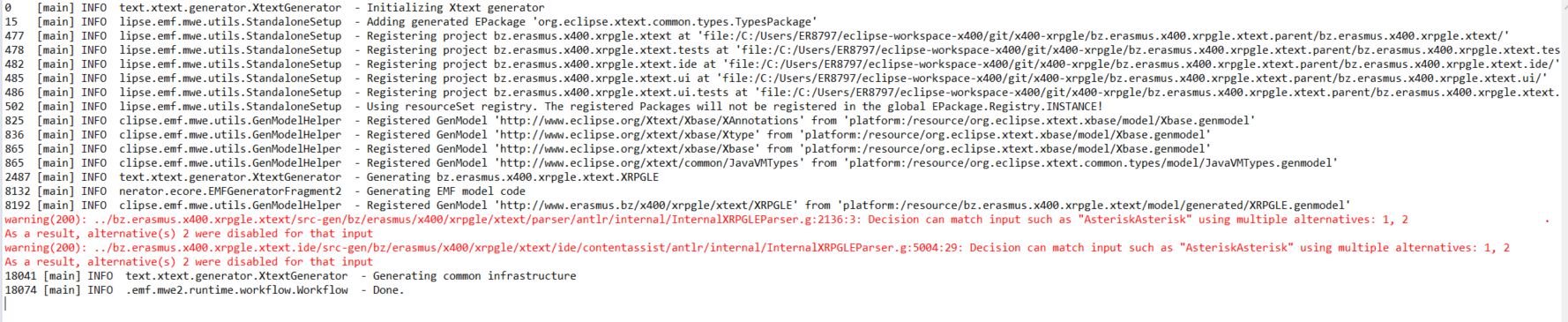

But... During the generation of the Langauge 2 warnings are generated (reference screenshot below).
Should I be concerned about them?

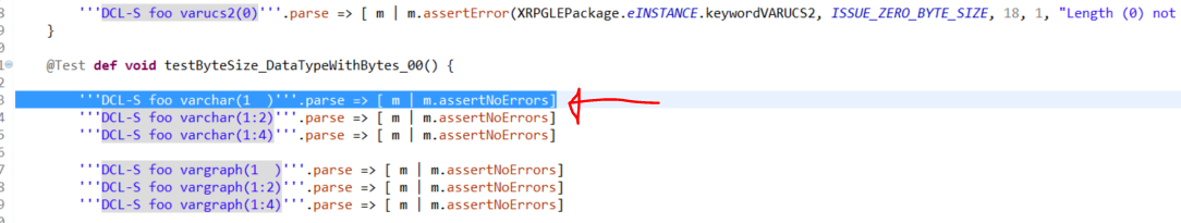

Spoke to soon, the change broke the maven build.
This test method, used to pass but now fails.
	@Test def void testByteSize_DataTypeWithBytes_00() {
		'''DCL-S foo varchar(1  )'''.parse => [ m |	m.assertNoErrors]
		'''DCL-S foo varchar(1:2)'''.parse => [ m |	m.assertNoErrors]
		'''DCL-S foo varchar(1:4)'''.parse => [ m |	m.assertNoErrors]
		'''DCL-S foo vargraph(1  )'''.parse => [ m | m.assertNoErrors]
		'''DCL-S foo vargraph(1:2)'''.parse => [ m | m.assertNoErrors]
		'''DCL-S foo vargraph(1:4)'''.parse => [ m | m.assertNoErrors]
		'''DCL-S foo varucs2(1  )'''.parse => [ m |	m.assertNoErrors]
		'''DCL-S foo varucs2(1:2)'''.parse => [ m |	m.assertNoErrors]
		'''DCL-S foo varucs2(1:4)'''.parse => [ m |	m.assertNoErrors]
  • Attachment: XRPGLE.xtext
    (Size: 5.25KB, Downloaded 97 times)
[Updated on: Wed, 29 November 2017 09:22] by Moderator

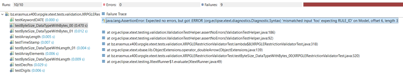

But the @Test (above) still fails, see attached.
Re: Parsing Exponent Expression [message #1777478 is a reply to message #1777476] Wed, 29 November 2017 10:06 Go to previous messageGo to next message
foo is a keyword ?!? https://blogs.itemis.com/en/xtext-hint-identifiers-conflicting-with-keywords
Re: Parsing Exponent Expression [message #1777480 is a reply to message #1777478] Wed, 29 November 2017 10:12 Go to previous message
Whoops... 'foo' was not meant to be a keyword.
Thanks for all the help.
