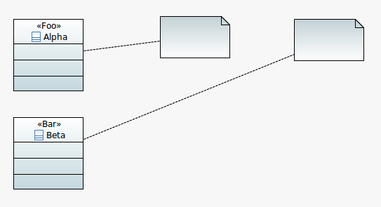

Thanks Camille but it does not seem to work.
This is my stylesheet:
StereotypeComment Compartment[stereotype="Foo"]{
   visible: true;
StereotypeComment Compartment[stereotype="Bar"]{
   visible: false;
StereotypeComment {
   visible: true;
And this is what I get:
http://www.morcilab.net/img/foobar.png
That is the stereotype comment is displayed for BOTH Foo and Bar.
Edit: unless you mean that the bug you refer to makes the comment appear also for Bar even if the corresponding compartment is not visible, but you wrote "empty", not "visible", and, to me, "empty" is to be referred to the metamodel and "visible" to the notation.

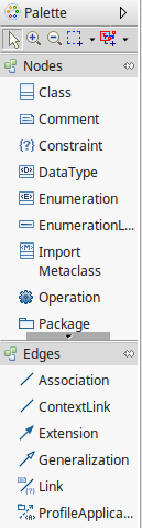

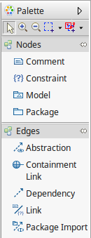

As a sidenote: for this example I tired creating a new profile model with Oxygen and the palette in the profile diagram is as follows:
http://www.morcilab.net/img/pal1.png
there are a lot of missing elements (among which "Import Metaclass" that makes the editor useless). Not only the palette was fine in Neon but also appears fine in Oxygen if I create the model in Neon and then import it in Oxygen as for the following image:
http://www.morcilab.net/img/pal2.png
Is that a bug or am I missing something?
