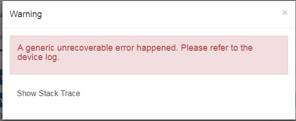

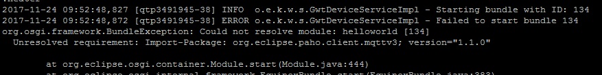

But when I go to "Kura->Devices->Bundles" the state is "Installed"instead of "Active" and when I try to start it, show an error
index.php/fa/31384/0/
index.php/fa/31385/0/
Someone has some idea about how can I solve this or how have I to do to send mqtt msg from Kura to mosquito.

I believe you have to wrap paho in your bundle.
As stated in the console, that dependency is missing.

I have added paho library in the manifest "org.eclipse.paho.client.mqttv3;version="1.1.0"".
Matteo Maiero wrote on Tue, 28 November 2017 09:05
Matteo
