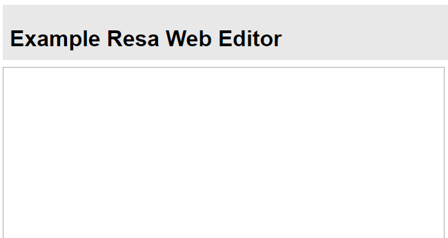

I am just starting the Xtext web-based editor. I created an Xtext project with Web Integration checked and Preferred Build System Maven. I also checked Create Update Site . Once the projects are generated, I generated the Xtext Artifacts before I run the Maven install command. The build process went successful. I opened the index.html , however, the web editor is disabled in other words, i cannot write text inside the editor, even if the web page seems to be correctly displayed.

Can you share the complete example project.
Diagnosing from screenshot is hard
And what do you mean by open index html
You usually call a maven command or a Java. Aim that starts a server
(There should be a runserver launcher or something like that in the project)
[Updated on: Mon, 20 November 2017 15:09] by Moderator
Re: Xtext web editor is disabled [message #1776732 is a reply to message #1776730] Mon, 20 November 2017 15:49 Go to previous message
That is right Christian, I had to run the launcher first. It is working :)
