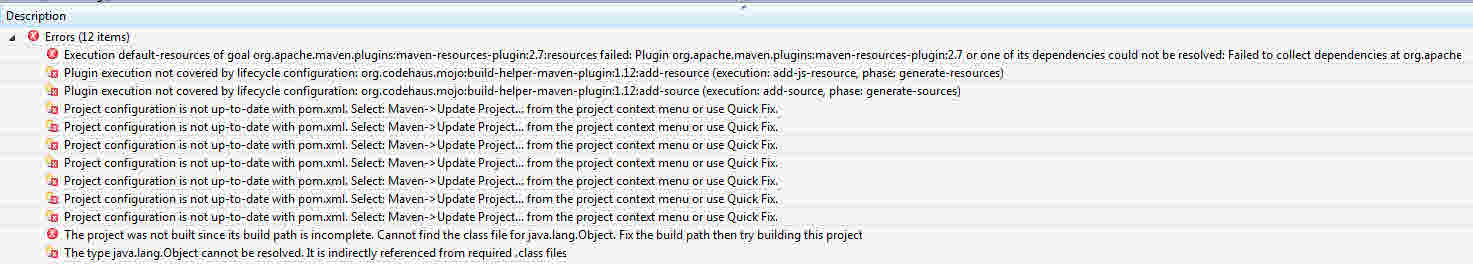

Re: How to install Eclipse Oxygen Scout behind a proxy [message #1783943 is a reply to message #1776970] Tue, 20 March 2018 11:31 Go to previous messageGo to next message
Hi Matthias,
I followed your suggestions but when I created a new Scout project return to me the following errors
index.php/fa/32381/0/
And in console I found this
[SEVERE]: Unable to create Scout Project.
org.eclipse.core.runtime.CoreException: Unable to create Scout Project.
	at org.eclipse.scout.sdk.s2e.operation.project.ScoutProjectNewOperation.run(ScoutProjectNewOperation.java:100)
	at org.eclipse.scout.sdk.s2e.job.ResourceBlockingOperationJob.run(ResourceBlockingOperationJob.java:112)
	at org.eclipse.scout.sdk.s2e.job.AbstractResourceBlockingJob.execute(AbstractResourceBlockingJob.java:64)
	at org.eclipse.scout.sdk.s2e.job.AbstractJob.runInternal(AbstractJob.java:107)
	at org.eclipse.scout.sdk.s2e.job.AbstractJob.run(AbstractJob.java:71)
	at org.eclipse.core.internal.jobs.Worker.run(Worker.java:56)
Caused by: org.eclipse.core.runtime.CoreException: Could not get the value for parameter encoding for plugin execution default-resources
	at org.eclipse.m2e.core.internal.embedder.MavenImpl.getMojoParameterValue(MavenImpl.java:950)
	at org.eclipse.m2e.core.internal.embedder.MavenImpl$6.call(MavenImpl.java:959)
	at org.eclipse.m2e.core.internal.embedder.MavenExecutionContext.executeBare(MavenExecutionContext.java:177)
	at org.eclipse.m2e.core.internal.embedder.MavenExecutionContext.execute(MavenExecutionContext.java:112)
	at org.eclipse.m2e.core.internal.embedder.MavenImpl.getMojoParameterValue(MavenImpl.java:957)
	at org.eclipse.m2e.jdt.internal.AbstractJavaProjectConfigurator.addProjectSourceFolders(AbstractJavaProjectConfigurator.java:299)
	at org.eclipse.m2e.jdt.internal.AbstractJavaProjectConfigurator.configure(AbstractJavaProjectConfigurator.java:126)
	at org.eclipse.m2e.core.project.configurator.AbstractLifecycleMapping.configure(AbstractLifecycleMapping.java:120)
	at org.eclipse.m2e.core.internal.project.ProjectConfigurationManager$3.call(ProjectConfigurationManager.java:508)
	at org.eclipse.m2e.core.internal.project.ProjectConfigurationManager$3.call(ProjectConfigurationManager.java:1)
	at org.eclipse.m2e.core.internal.embedder.MavenExecutionContext.execute(MavenExecutionContext.java:151)
	at org.eclipse.m2e.core.internal.project.ProjectConfigurationManager.updateProjectConfiguration(ProjectConfigurationManager.java:501)
	at org.eclipse.m2e.core.internal.project.ProjectConfigurationManager.configureNewMavenProjects(ProjectConfigurationManager.java:288)
	at org.eclipse.m2e.core.internal.project.ProjectConfigurationManager$1.call(ProjectConfigurationManager.java:175)
	at org.eclipse.m2e.core.internal.project.ProjectConfigurationManager$1.call(ProjectConfigurationManager.java:1)
	at org.eclipse.m2e.core.internal.embedder.MavenExecutionContext.execute(MavenExecutionContext.java:99)
	at org.eclipse.m2e.core.internal.embedder.MavenImpl.execute(MavenImpl.java:1355)
	at org.eclipse.m2e.core.internal.project.ProjectConfigurationManager.importProjects(ProjectConfigurationManager.java:143)
	at org.eclipse.m2e.core.internal.project.ProjectConfigurationManager.importProjects(ProjectConfigurationManager.java:133)
	at org.eclipse.scout.sdk.s2e.operation.project.ScoutProjectNewOperation.importIntoWorkspace(ScoutProjectNewOperation.java:148)
	at org.eclipse.scout.sdk.s2e.operation.project.ScoutProjectNewOperation.run(ScoutProjectNewOperation.java:94)
	... 5 more
Caused by: org.apache.maven.plugin.PluginResolutionException: Plugin org.apache.maven.plugins:maven-resources-plugin:2.7 or one of its dependencies could not be resolved: Failed to collect dependencies at org.apache.maven.plugins:maven-resources-plugin:jar:2.7 -> org.apache.maven:maven-project:jar:2.2.1 -> org.apache.maven:maven-settings:jar:2.2.1 -> org.codehaus.plexus:plexus-container-default:jar:1.0-alpha-9-stable-1 -> junit:junit:jar:3.8.1
	at org.apache.maven.plugin.internal.DefaultPluginDependenciesResolver.resolveInternal(DefaultPluginDependenciesResolver.java:214)
	at org.apache.maven.plugin.internal.DefaultPluginDependenciesResolver.resolve(DefaultPluginDependenciesResolver.java:149)
	at org.eclipse.m2e.core.internal.project.registry.EclipsePluginDependenciesResolver.resolve(EclipsePluginDependenciesResolver.java:59)
	at org.apache.maven.plugin.internal.DefaultMavenPluginManager.createPluginRealm(DefaultMavenPluginManager.java:400)
	at org.apache.maven.plugin.internal.DefaultMavenPluginManager.setupPluginRealm(DefaultMavenPluginManager.java:372)
	at org.apache.maven.plugin.DefaultBuildPluginManager.getPluginRealm(DefaultBuildPluginManager.java:231)
	at org.eclipse.m2e.core.internal.embedder.MavenImpl.getMojoParameterValue(MavenImpl.java:925)
	... 28 more
Caused by: org.eclipse.aether.collection.DependencyCollectionException: Failed to collect dependencies at org.apache.maven.plugins:maven-resources-plugin:jar:2.7 -> org.apache.maven:maven-project:jar:2.2.1 -> org.apache.maven:maven-settings:jar:2.2.1 -> org.codehaus.plexus:plexus-container-default:jar:1.0-alpha-9-stable-1 -> junit:junit:jar:3.8.1
	at org.eclipse.aether.internal.impl.DefaultDependencyCollector.collectDependencies(DefaultDependencyCollector.java:291)
	at org.eclipse.aether.internal.impl.DefaultRepositorySystem.collectDependencies(DefaultRepositorySystem.java:316)
	at org.apache.maven.plugin.internal.DefaultPluginDependenciesResolver.resolveInternal(DefaultPluginDependenciesResolver.java:202)
	... 34 more
Caused by: org.eclipse.aether.resolution.ArtifactDescriptorException: Failed to read artifact descriptor for junit:junit:jar:3.8.1
	at org.apache.maven.repository.internal.DefaultArtifactDescriptorReader.loadPom(DefaultArtifactDescriptorReader.java:282)
	at org.apache.maven.repository.internal.DefaultArtifactDescriptorReader.readArtifactDescriptor(DefaultArtifactDescriptorReader.java:198)
	at org.eclipse.aether.internal.impl.DefaultDependencyCollector.resolveCachedArtifactDescriptor(DefaultDependencyCollector.java:535)
	at org.eclipse.aether.internal.impl.DefaultDependencyCollector.getArtifactDescriptorResult(DefaultDependencyCollector.java:519)
	at org.eclipse.aether.internal.impl.DefaultDependencyCollector.processDependency(DefaultDependencyCollector.java:409)
	at org.eclipse.aether.internal.impl.DefaultDependencyCollector.processDependency(DefaultDependencyCollector.java:363)

How can I solve them?
Thanks in advance for any helps and suggestions
Marco
  • Attachment: Error.jpg
    (Size: 47.75KB, Downloaded 919 times)
[Updated on: Tue, 20 March 2018 11:46] by Moderator
Re: How to install Eclipse Oxygen Scout behind a proxy [message #1784135 is a reply to message #1783943] Thu, 22 March 2018 14:32 Go to previous message
Hi Marco
You can also try to set the proxy settings in your Maven settings.xml.
See here for more details.
Does this help?
