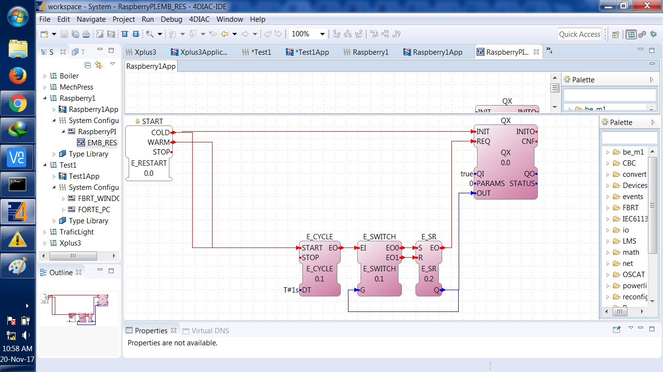

I am new to 4DIAC. Follwoing is my Envirnment:
1) I have insallated 4DIAC on window7.
2) I deploy forte on RaspbeeryPi using this link:
https://www.eclipse.org/4diac/documentation/html/installation/raspi.html
3) Please see attached images that show LED Blink, program i build in 4DIAC on win7.

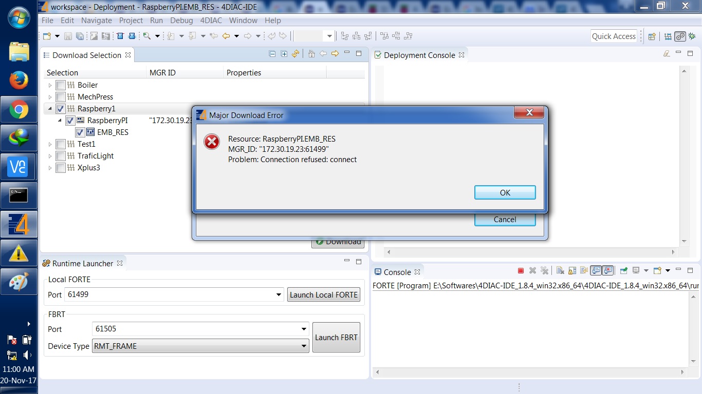

4)When I download program, it shows connect error, please see Step4_pic1

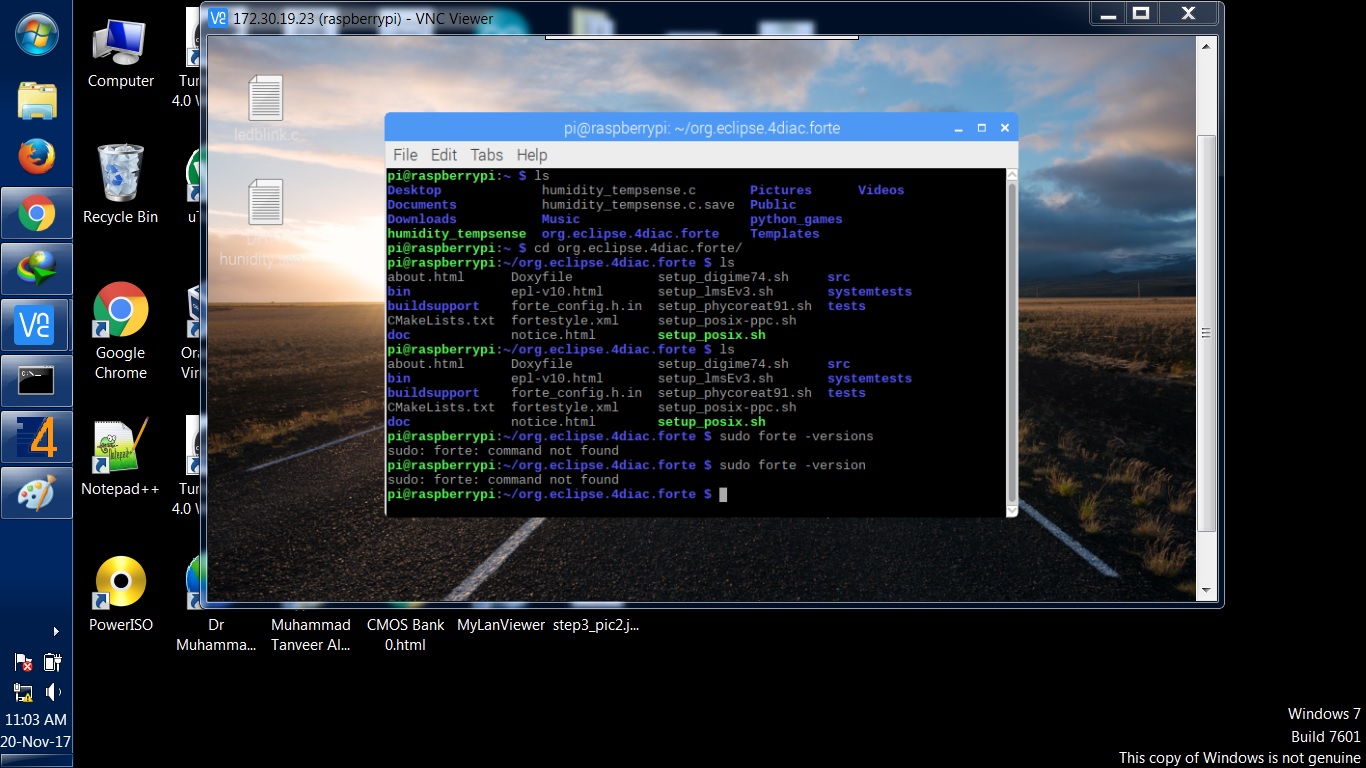

5) For Rasberry forte, please see pic: step5_pic2

You are on the wrong folder in your RPI. Once you compile Forte on your RPI, you should start it by entering in org.eclipse.4diac.forte/bin/posix/src/ and then you should start forte by running
./forte
also, forte doesn't have a versions flag or alike.

Thanks alot! problem has been resolved. Can your please add some mechanism that send alter to you, when someone replay on your problem.
