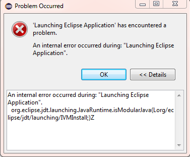

This is a very strange issue:
Yesterday I used xtext for my project and it works fine.
Today I open the eclipse, select my xtext project, Run as Eclipse Application, then error occurred:
An internal error occurred during: "Launching Eclipse Application".
org.eclipse.jdt.launching.JavaRuntime.isModularJava(Lorg/eclipse/jdt/launching/IVMInstall;)Z
index.php/fa/31294/0/
I have no idea what cause this issue. (perhaps my environment problem?)
So I start a clean win7 snapshot image in my vmware.
1. install jdk-8u101-windows-x64.exe
2. install eclipse-java-oxygen-R-win32-x86_64
3. run eclipse and install new software for xtext
Oxygen - http://download.eclipse.org/releases/oxygen
Modeling/Xtext Complete SDK 2.120.v20170519-1412
4. Create Xtext/Xtext Project (org.xtext.example.mydsl)
Everything use defauly settings.
5. Select GenerateMyDsl.mwe2 and run it.
6. Select Project and Run as Eclipse Application
But the error still occurred....
Anyone here and encountered the same problem?
Need for help.
Very thanks.
  • Attachment: Capture.PNG
    (Size: 16.33KB, Downloaded 8702 times)
Re: Internal error occurred during: "Launching Launch Runtime Eclipse" [message #1776567 is a reply to message #1776507] Fri, 17 November 2017 14:22 Go to previous messageGo to next message
Please attach the complete error log from the error view
Re: Internal error occurred during: "Launching Launch Runtime Eclipse" [message #1776568 is a reply to message #1776567] Fri, 17 November 2017 14:23 Go to previous messageGo to next message
And ps: which java version do you use?
Re: Internal error occurred during: "Launching Launch Runtime Eclipse" [message #1776586 is a reply to message #1776568] Fri, 17 November 2017 21:18 Go to previous messageGo to next message
Christian Dietrich wrote on Fri, 17 November 2017 19:22
!ENTRY org.eclipse.core.jobs 4 2 2017-11-18 10:15:29.905
!MESSAGE An internal error occurred during: "Launching Launch Runtime Eclipse".
!STACK 0
java.lang.NoSuchMethodError: org.eclipse.jdt.launching.JavaRuntime.isModularJava(Lorg/eclipse/jdt/launching/IVMInstall;)Z
at org.eclipse.pde.launching.AbstractPDELaunchConfiguration.launch(AbstractPDELaunchConfiguration.java:77)
at org.eclipse.debug.internal.core.LaunchConfiguration.launch(LaunchConfiguration.java:885)
at org.eclipse.debug.internal.core.LaunchConfiguration.launch(LaunchConfiguration.java:739)
at org.eclipse.debug.internal.ui.DebugUIPlugin.buildAndLaunch(DebugUIPlugin.java:1039)
at org.eclipse.debug.internal.ui.DebugUIPlugin$8.run(DebugUIPlugin.java:1256)
at org.eclipse.core.internal.jobs.Worker.run(Worker.java:56)
Christian Dietrich wrote on Fri, 17 November 2017 19:23
Java version:
java version "1.8.0_101"
Java(TM) SE Runtime Environment (build 1.8.0_101-b13)
Java HotSpot(TM) 64-Bit Server VM (build 25.101-b13, mixed mode)
Install package: jdk-8u101-windows-x64.exe
[Updated on: Fri, 17 November 2017 21:20] by Moderator
