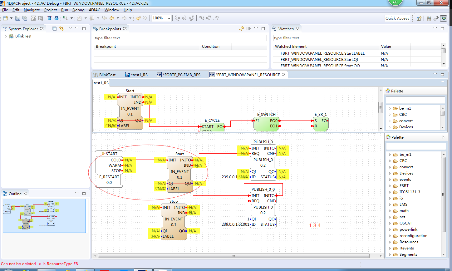

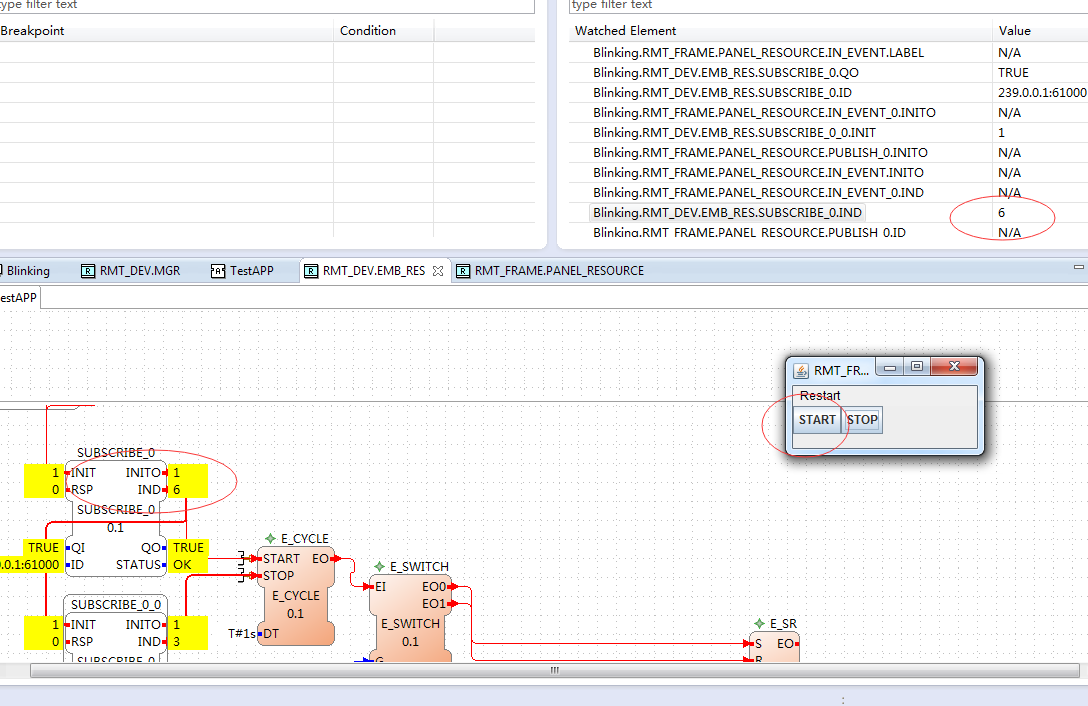

think you! I figure it out that the mingw32-make.exe and make.exe both exist is OK,
I just change mingw32-make.exe into make.exe last time.
But i found a bug that FBDK function block cannot respond when i use IN-EVENT to test
the Blinking Project with version 1.8.4 and 1.9.0M1 . however, in 1.7.4 it can work.

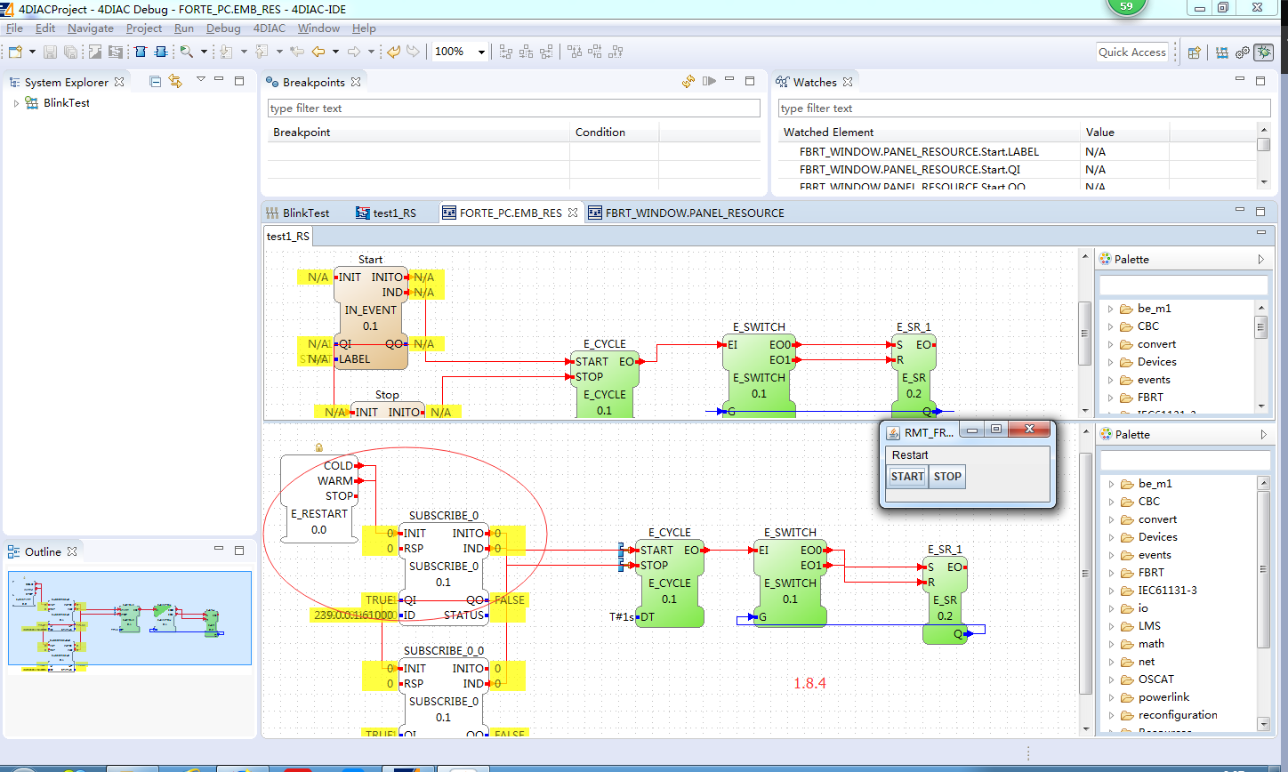

Unfortunately the 4diac monitoring is not working for FBDK devices. But I noticed in your 1.8.4 screenshot that the Subscribe block was not initalized. This may be the reason that you are not receiving anything from the IN_EVENT.

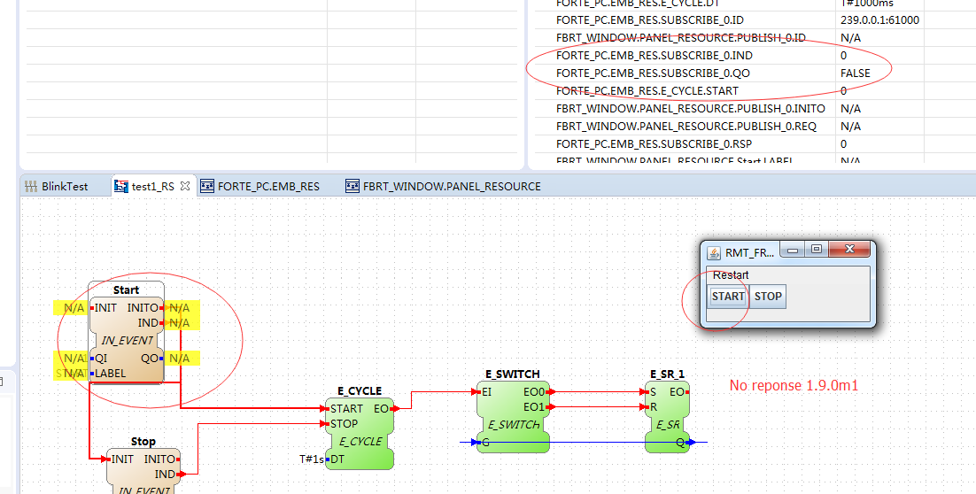

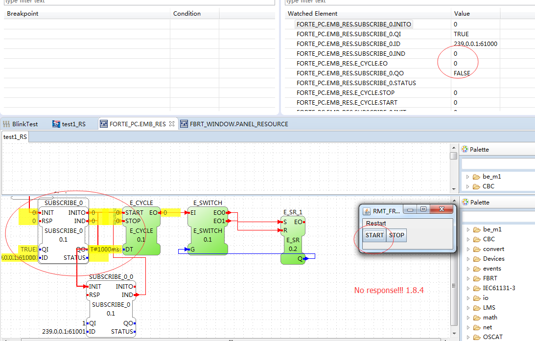

hi, professor,think you for your reply.
I do check my test and the subscribe fb was initalized.
although the 4diac monitoring is not working for FBDK devices, the control effect should be reflected in E-CYCLE. but E-CYCLE can't be triggered.
E-CYCLE can work when I trigger event manually.

After trying many times, I found the reason for this situation。
because the workspace path contains Chinese character . After changing the path, it works.

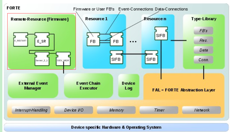

I have a question about the forte overiew.
1 what does the resource mean?
2 what does the remote-resource mean?
is it means remote I/O or local interface driver or something else?
AND what the difference between resource and remote-resource?

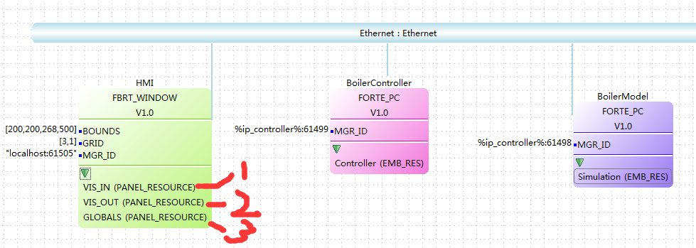

3 One device may contains more than one resource in boiler example. how does these
resource work with each other?

a resource is defined in IEC 64199 as application container within a device. That means that resources are the target when mapping applications to devices. Devices may have several resources. Resources have to shield the execution within them from other resources. As with nearly all elements in IEC 61499 there are resource types. The different resource types may already provide special functionality for the application they are running in. For more details on the device and resource model please have a look on an IEC 61499 introduction.
The RMT_RES is a special resource defined in the "IEC 61499 Compliance profile for feasibility demonstrations" [1]. The task of this resource is to open up a TCP port so that engineering tools like 4diac-ide can connect to and configure the device.
