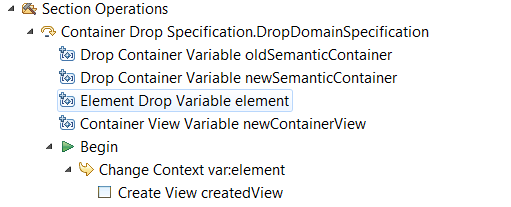

In the Section Tools, I have created a tool to create Container. Now, I have created another tool "Container Drop" and the operation in begin is "Create View". (see image).
So the scenario is: I have created this container in one diagram A and dragged-dropped from model to other instances of diagram A.

2. Since, the dragged and dropped container is having only view (create view) in other diagram and when I do the container.eContainer().eAllContents() it does not show the container that is dropped here. How can I see the containers that are created else where but also represented in the current diagram.

2. I do not understand your question. You can't have only view in other diagram, graphical elements are based on semantic elements. I assume that your are working on unsychronized diagram if you need drag and drop tools creating views. Then you start from a blank diagram and use your tool to only display the semantic elements you want on your diagram. Right? Then if you want to access other representation of a semantic element you should use the semantic cross referencer as in answer 1.
