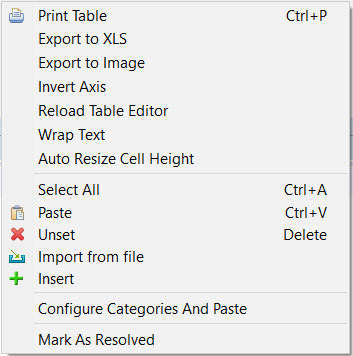

I have converted a SysML 1.1 model into SysML 1.4 using Papyrus 2.0.3.
Now I correctly open the model with Papyrus 3.1.0, but tables have a problem: the contextual menu is not standard (see the picture) and it is not possible to change columns.
In error log I have seen the following one:

I must add that when I create a new SysML 1.4 model from scratch and I create a table, the context menu is standard, allowing me to change columns.

Papyrus 3.x.0 - wrong context menu of tables - FIXED [message #1776109 is a reply to message #1775857] Sat, 11 November 2017 11:22 Go to previous message
with a bit of troubleshooting I have identified the problem and, I hope, definitely fixed.
During the transformation I have corrupted some ElementImport items, i.e. their referenced element was null.
This null reference probably was not trapped within
org.eclipse.papyrus.uml.nattable.provider.UMLStereotypeRestrictedPropertyContentProvider.getInstancesFilteredByType
After removing the wrong ElementImport items, the context menu is now correct.
Best Regards,
Nicola
