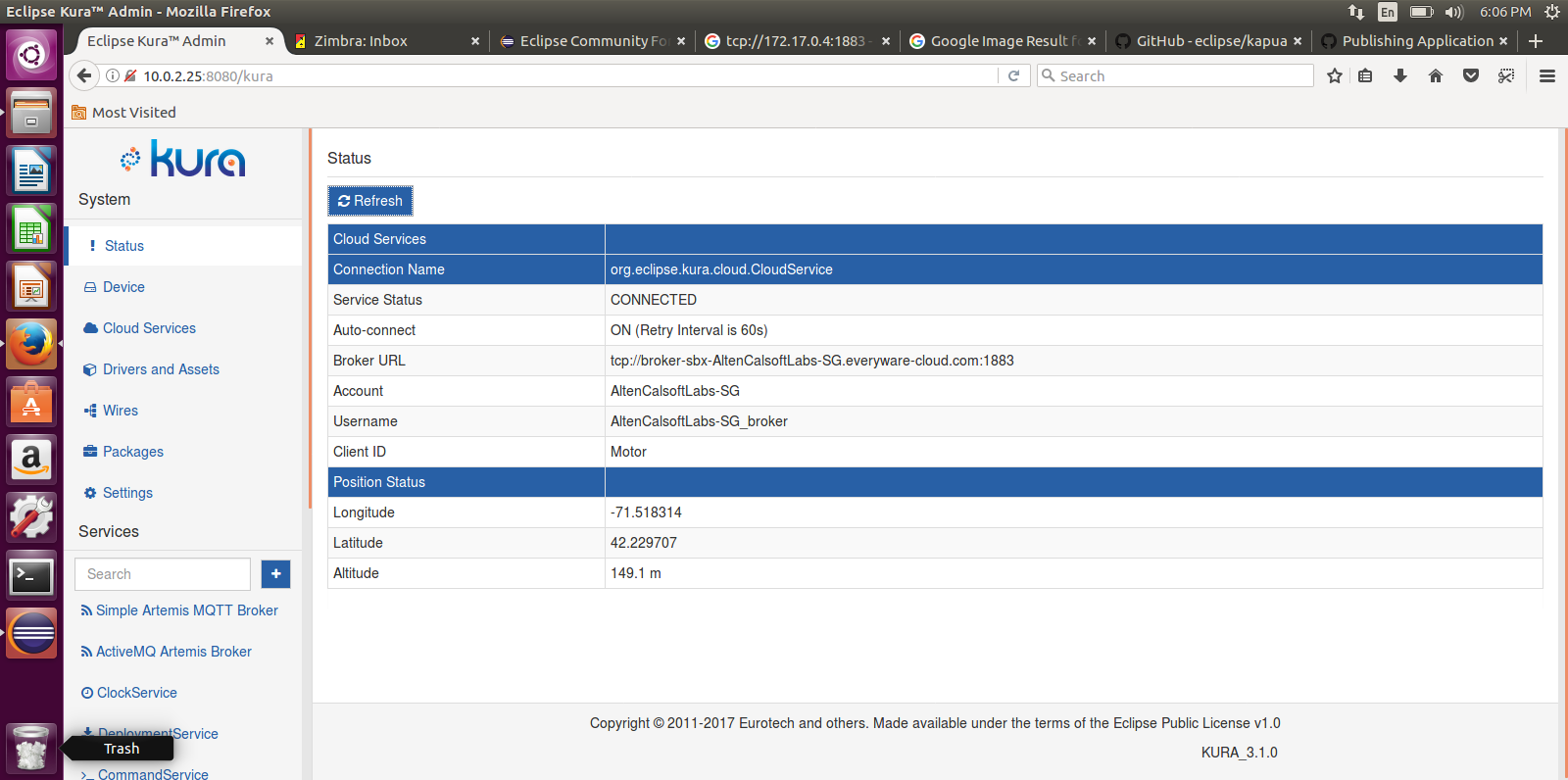

Re: publishing application [message #1775508 is a reply to message #1775506] Tue, 31 October 2017 03:36 Go to previous messageGo to next message
after importing of kura workspace archive file some example projects are imported, demo heater is one of them and no errors in project.
following is the osgi console.

Re: publishing application [message #1775511 is a reply to message #1775508] Tue, 31 October 2017 04:45 Go to previous messageGo to next message
I believe that you are not connected to a cloud platform.
For this reason the messages produced are stacked in the local database waiting to be pushed. But now the database is full and it cannot accept more messages.
Matteo

hi,
following is the eclipse console. and attached file is the webui.
