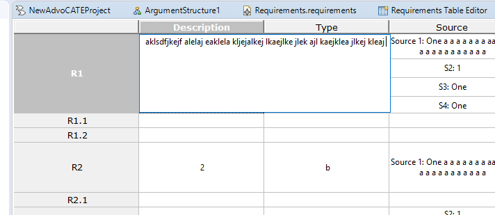

Thanks for the response. When trying out the MultiLineTextCellEditor, I got some strange results. It says it should disable commit on enter, however when pressing enter it does commit the changes. Also, instead of wrapping text, it grows the cell horizontally when the text becomes larger than the cell bounds. See the attached image for what happens. Here's the code where I register the MultiLineTextCellEditor.
    configRegistry.registerConfigAttribute(
        EditConfigAttributes.CELL_EDITOR, new MultiLineTextCellEditor(true),
        DisplayMode.EDIT, RequirementsTableConstants.COLUMN_WITH_SINGLE_ENTRY_LABEL);
