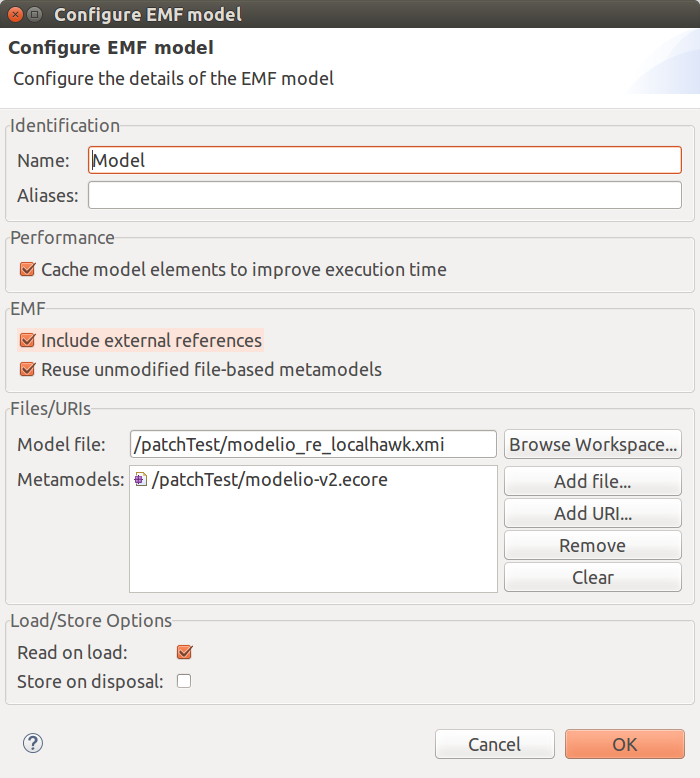

Hi Antonio,
The code you have seems OK, but I think unchecking the "include external references" box in the EMF Model options should serve the same purpose, and you should be able to still do "X.all" as normal.
Could you try that out and let us know how it works for you?
