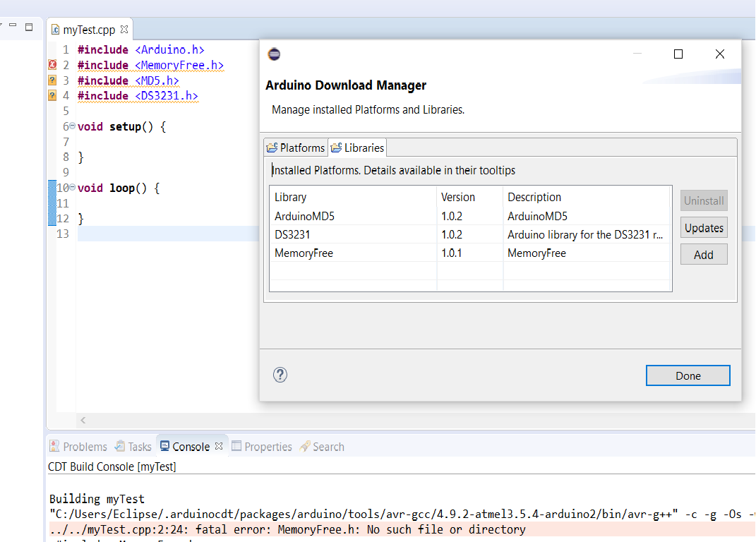

Just did a clean install of Eclipse Photon.
Same problem, Unresolved include.
See picture.
By the way, Windows locale settings are for Portuguese/Brazil
Paulo
index.php/fa/33532/0/
Re: Arduino Library Management With Symlinks [message #1793134 is a reply to message #1793051] Tue, 31 July 2018 09:20 Go to previous messageGo to next message
It appears that you're doing it correctly. I haven't tried this on Photon yet; I've been using Oxygen. Is MemoryFree the only external library you've added? Can you try added a different one to see if it works?
Re: Arduino Library Management With Symlinks [message #1793178 is a reply to message #1793134] Tue, 31 July 2018 22:39 Go to previous messageGo to next message
Dear Isaac, thanks for the response.
I kept trying and found how to sort it out.
Indeed it is not intuitive at all.
What did I do:
Install Eclipse as per instructions in the following video (even if it is not Photon)
https://www.youtube.com/watch?v=TtPvkPpAx0E
Copy library folder to:
C:\Users\USERNAME\.arduinocdt\libraries
Library MUST include file library.properties as following example:
name=LibraryName
version=1.0
author=John_Smith
maintainer=Andrew_Smith
sentence=MemoryStatus
paragraph=MemoryStatus.
category=MemoryStatusurl=https://github.com/XXX/12345
architectures=*
includes=*
I used Windows Notepad and all the above appears in a single line, no spaces, no CR/LF at the end, replace example labels with proper from the library
(some libraries at Github include the library.properties file
To build your own try to look on built in library folder and see how the file library.properties looks.
Right click project, select properties/Libraries
Confirm (click) every library that must be included in the project
Paulo
