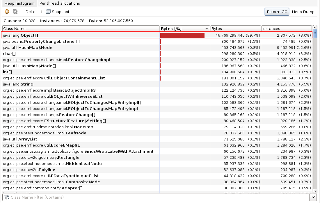

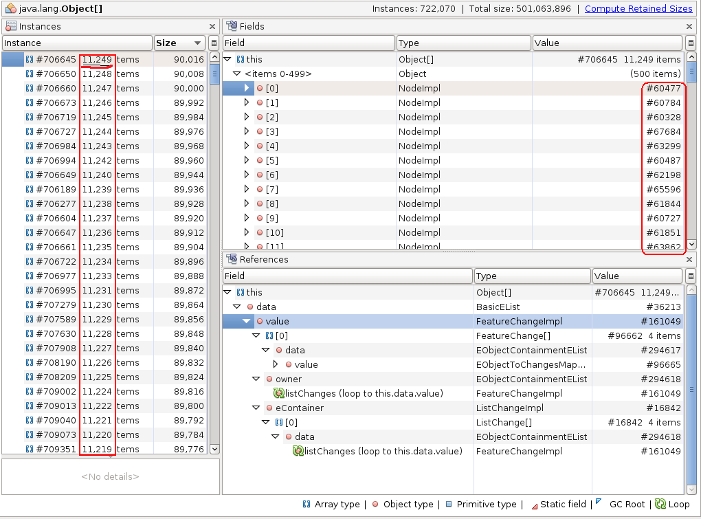

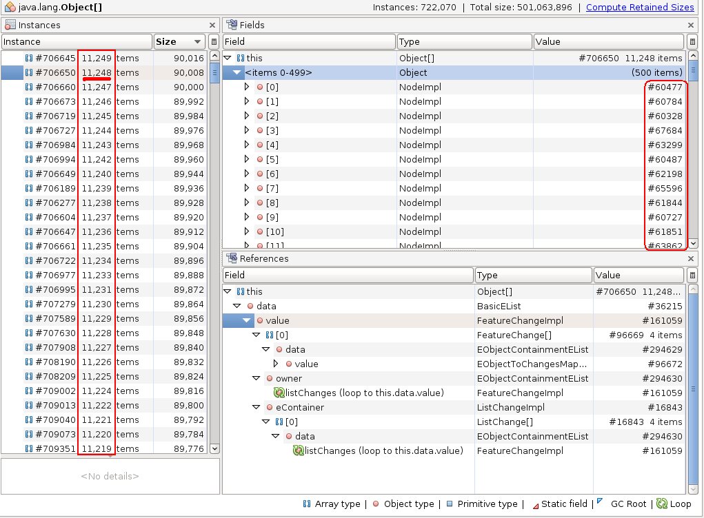

I found a interesting phenomenon, if i create a Sirius diagram for a big size model (100,000), the biggest memory consumer is object array (java.long.object[]), it occupied over 80% memory.
And I found many of the object array stores NodeImpl instances, but the size of these array is reduced one by one (Show in the pictures). This cause the memory grows in speed of O(n²) by model size. I think this may be a memory leak or bad strategy in somewhere.

Re: Duplication memory in Sirius, GMF or EMF? [message #1775052 is a reply to message #1775006] Tue, 24 October 2017 04:45 Go to previous messageGo to next message
Thank you for your analyse.
If I understand correctly these arrays are referenced by feature changes that are not meant to be persistent but more punctual.
So these should be garbageable at some point.
I imagine it grows only from a short time when node are loaded maybe or in another situation.
Pierre
[Updated on: Tue, 24 October 2017 05:10] by Moderator

After i created the diagram and opened it, i did several times GC, then take the "Heap dump" operation. I analyse the heapdump file. So, maybe other Objects reference to "FeatureChangeImpl" instance indirectly, then bring this problem.
Re: Duplication memory in Sirius, GMF or EMF? [message #1775090 is a reply to message #1775063] Tue, 24 October 2017 09:27 Go to previous messageGo to next message
Ok feature changes are kept for undo/redo purpose so they can be present in memory for some time until it is cleared either by crossing a limit or a save I guess.
It works with an old/new value mechanic. So if you add a node in a list, your change will have as old value the old list and as new value a new list containing the new node.
The difference must be kept to be able to reverse the change.
So I don't think we can do much about it.
However GMF deals not really well with this kind of graphical element number for one diagram. If you could split this number with more representations you would have more efficiency.

After i created a Sirius diagram and opened it, I checked the undolist in DefaultOperationHistory, found it only contains two EMFCommandOperations. One of the EMFCommandOperations which contains CreateRepresentatinCommand, that contains many FeatureChangeImpl instances.
I think the CreateRepresentatinCommand and RefreshRepresentatinCommand should not support the undo function, i override the canUndo() function in these two command, but it didn't work.
Another thing, while executing CreateRepresentatinCommand, it will create many NodeImpl instances. Each creation of NodeImpl instance will create a new transaction and the transaction will produce the ChangeDescription (I do not very clear about this process).
I guess if the creation of NodeImpl do not use transaction, maybe the memory problem will be resolved.
