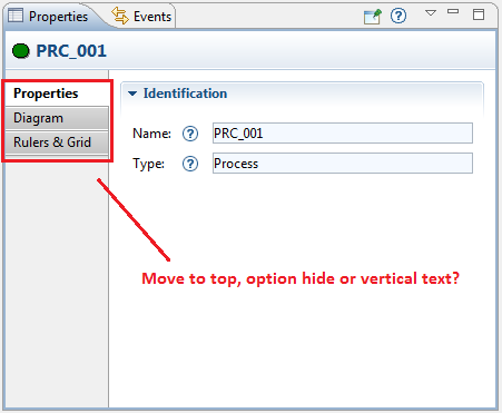

I have a query about Propertis View. Tabs names in the Properties View are on the left side and occupy a large amount of content (see picture).
It is possible that the tabs at the top, or it can hide the tabs, or that tab names vertically?
Thanks.
Martin
Re: Tabs names in the Properties View occupies a large part of the content [message #1774991 is a reply to message #1774976] Mon, 23 October 2017 05:30 Go to previous message
You can use the org.eclipse.eef.properties.ui.eefTabDescriptorFilter extension point to hide tabs. See https://www.eclipse.org/eef/#/documentation/2.0.0/developerguide/eeftabdescriptorfilter
But the view cannot be configured with graphical buttons to hide/show, resize or have vertical names.
