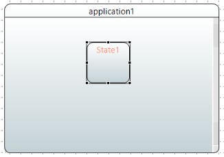

Re: CSS not apply [message #1775060 is a reply to message #1775023] Tue, 24 October 2017 05:18 Go to previous messageGo to next message
Hi Quentin,
I've tried other colors, but the result is the same. The default background color appears to be a gradient of blue:
index.php/fa/31115/0/
And it don't change.
I've tried only "white" in place of fffff, and added "gradient:none". No result.
Re: CSS not apply [message #1775236 is a reply to message #1775060] Thu, 26 October 2017 11:16 Go to previous messageGo to next message
I've found that code in papyrus css theme:
	fillColor:#C3D1D5;
	gradient: white vertical;
	elementIcon: true;
it's the default color applied on my shape.
Maybe the "*" is apply after my style, or his properties are'n't overridable ?
