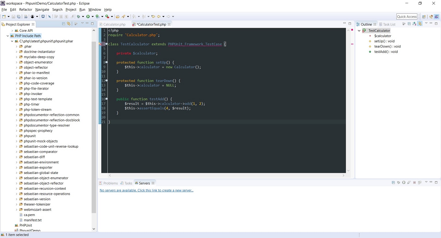

Hello:
I just downloaded and started running Oxygen.1.
I also installed Composer and PHPUnit in accordance with Chapter 1, the Windows section, from the documentation:
https://phpunit.de/manual/current/en/phpunit-book.pdf
Back in Eclipse I went to In Eclipse install the packages from http://download.eclipse.org/tools/pdt/updates/latest and installed the "PHP Development Tools" (Note: Under "PHP Development Tools (SDK), "PHP Development Tools (PDT) JUnit Tests" showed up in the "Will not be installed" part of the Solution Details section).
So I went into Project -> Properties -> PHP -> Source Paths -> Include Path -> Libraries,
I clicked Add External PHARs... and pointed the file chooser to the home of where I put PHPUnit, c:\php\latest\phpunit\phpunit.phar.
After that, in the Project Explorer tabbed pane, in the PHP Include Path node of the project tree, I can expand phpunit.phar and see all the packages underneath...
Here's the source code:
CalculatorTest.php
<?php
require 'Calculator.php';
class TestCalculator extends PHPUnit_Framework_TestCase {
    private $calculator;
    protected function setUp() {
        $this->calculator = new Calculator();
    protected function tearDown() {
        $this->calculator = NULL;
    public function testAdd() {
        $result = $this->calculator->add(1, 2);
        $this->assertEquals(4, $result);
Calculator.php
<?php
class Calculator
    public function add($x, $y)
       return $x + $y;

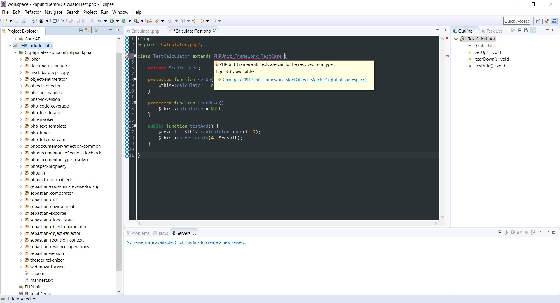

For this line in the code:
Eclipse has an error, "Quote:
PHPUnit_Framework_TestCase cannot be resolved to a type
Eclipse tells me to change it to PHPUnit_Framework_MockObject_Matcher instead... so I do so...
But when going to Run -> Run As _> PHPUnit Test, this popup is displayed:
"Quote:
Unable to find PHPUnit phar Check PHPUnit configuration
Does anyone have any ideas how to get PHPUnit running in Oxygen.1? I've attached a couple of screenshots showing my Eclipse. Suggestions are greatly appreciated. Thanks!
  • Attachment: pic3.jpg
    (Size: 199.56KB, Downloaded 705 times)
  • Attachment: pic4.jpg
    (Size: 319.79KB, Downloaded 574 times)

It sounds like Eclipse is having trouble finding your PHPUnit PHAR. (This is a separate problem to the one where Eclipse complains that "PHPUnit_Framework_TestCase cannot be resolved to a type". This error has something to do with your include path but won't stop you from running the tests; if I were you I'd revert back to using PHPUnit_Framework_TestCase as PHPUnit_Framework_MockObject_Matcher is not a suitable replacement).
To resolve the error you're seeing you need to go to Window -> Preferences -> PHP -> Tools -> PHPUnit and set the PHPUnit Phar setting to the location of your PHPUnit phar.
Note that the Window -> Preferences might be under a different menu on different platforms, this is the location on Linux.

Try PDT 5.3 (Oxygen.3 released today). We improved PHPUnit support a lot.

Which one? "Unresolved Type" ? Make sure you have phpunit in your project build path. If you are using composer, PDT can take care of it.
