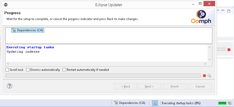

We use and apply a custom Target Platform using pde:TargetPlatformTask and it works well.
The only slight annoyance is that it applies itself at every startup. It's not something that changes often so it seems pointless (as in the devs have been whinging at me!).
I thought I could restrict the triggers, but I'm only allowed "MANUAL" which mean it won't get applied on initial setup.
I had a look through the code and I think I can see why it occurs:
  public boolean isNeeded(SetupTaskContext context) throws Exception {
    if (targetDefinition == null || !targetDefinition.isResolved() || !isActivate() || activeTargetDefinition == null
        || !targetDefinition.getHandle().equals(activeTargetDefinition.getHandle()))
Watching the startup, the target always seems to initially be "unsresolved", but it does get resolved before the setup tasks run.
index.php/fa/31014/0/
index.php/fa/31015/0/
So is that check worthwhile? It seems that any target platform will always be needed unless perhaps the check is performed later on.
