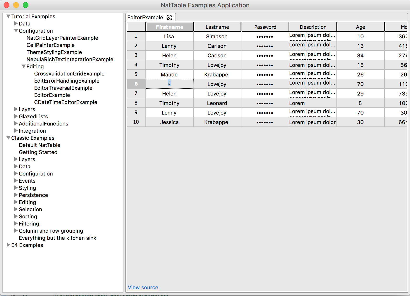

I'm making a program based on NatTable example _447_EditorExample.java.
(NatTable Examples Application>Tutorial Examples>Configuration>Editing>EditorExample)
When I moved selection by keyboard and enter new data, a cell editor opens and the first key input is selected(see attached nattable.png) and overwritten by next key input.

NatTable is using a SWT Text control for editing. So if it works on Windows but not on Mac I suppose there is an issue with SWT on Mac regarding the Text control and selection. EditorSelectionEnum.END is by the way the default, so I would expect that your code modified code does not change anything. Maybe there is an issue with Text#setSelection() on Mac.
As I don't have a Mac, I can't tell anything more. You could try to create an example that only uses a SWT Text control, and if you see that the issue is there, open a ticket for SWT.
