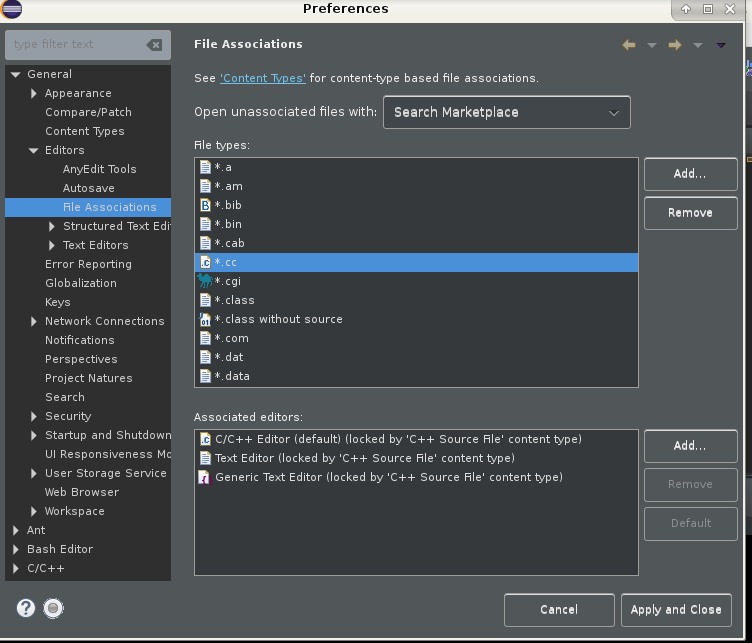

Have you added .cc as a C++ file extent?
If not then
Window --> Preferences --> General --> Editors --> File Associations --> Add...
Add .cc
And set or add C++ Editor to .cc
index.php/fa/30995/0/
Assuming you are using a Managed Build, the .cc files should be in the src directory.
  • Attachment: FileAssoc.png
    (Size: 66.38KB, Downloaded 1478 times)

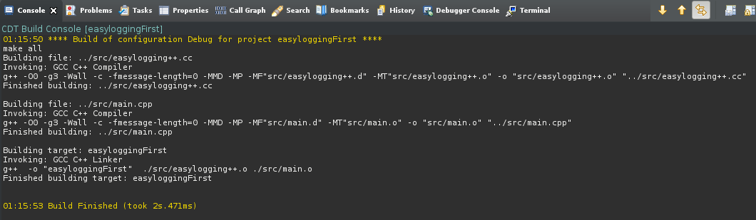

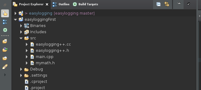

Re: Explicitly compiling more than one dependent files in Eclipse CDT [message #1774422 is a reply to message #1774337] Sat, 14 October 2017 01:18 Go to previous messageGo to next message
g++ compiling multiple source files is no different than compiling them separately then linking the object files.
https://stackoverflow.com/a/3202161
The easiest way to create a project is with File --> New --> C++ project --> Hello World C++ project.
Use the default location (the workspace) or somewhere else then set a project name.
Be sure to select the Linux GCC tool chain.
This will create a directory structure and set up the tool chain properly for a managed build which can be a bit tedious if importing as a makefile project.
The default configuration is Debug.
Delete the created sample source file src/<projname>.cpp
Place your files in the project src directory.
You may need to refresh the project in Project View using F5 afterwards.
Project --> Build Project
I created a test project this way using the main from your link then compiled and linked it.
I called the project easyloggingFirst
The configuration directory (Debug in this case) is created during the build.
It will contain the necessary makefiles, intermediate files and the resultant executable.
index.php/fa/31001/0/
index.php/fa/31002/0/
