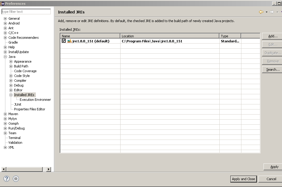

Re: Error sun/misc/BASE64Encoder [message #1774981 is a reply to message #1774185] Mon, 23 October 2017 03:34 Go to previous messageGo to next message
This is a picture which shows eclipse JRE preferences.
