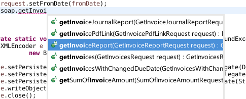

How can I make code completion window wider? See the attached picture. Now I can't see what is the return type of getInvoiceReport(...).

If you resize the hover window, it remember that size the next time it comes up. At least that's what it does for me on Windows.
