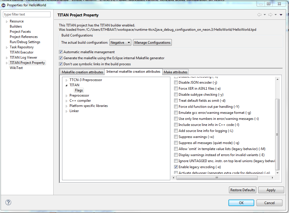

Re: Support for using tpds (TITAN Project Descriptor) in Eclipse Titan [message #1774666 is a reply to message #1774630] Wed, 18 October 2017 09:08 Go to previous messageGo to next message
Hi Alex,
I think Titan project configuration under "Manage Configuration" is what you seek.
It is an other concept of "configuration" than the config set by "configuration file" with extension .cfg.
In a Titan Eclipse project, You have a fixed set of folders, files and referred projects.
Any other set of the project properties ( for example, Makefile settings, set of exluded files and so on) can be collected to "project configurations".
For example, in your case I will sketch a simple project:
1. I created a Hello World project, and added two files, "PositiveTest.ttcn" and "NegativeTest.ttcn" to it.
2. I've created two configurations, "Positive" and "Negative".
3. I've selected proj. config. "Positive" and I've "excluded" file "NegativeTest.ttcn" from the build (This file will not be built) . It models the positive test handling. (see attached file NegativeTestConfig.PNG)
4. I've selected proj.config "Negative" and I've "excluded" "PositiveTest.ttcn".
Here I added a preprocessor macro "NEG_TEST" to this configuration and enabled legacy encoding (see referenceguide.pdf) just to demonstrate the concept of "project configuration".
5. I've exported the project settings into tpd file "HelloWorld.tpd" into the project folder.
Now we have three project configurations: Default, Positive and Negative.
-In Default: there aren't any excluded files, PositiveTest.ttcn and NegativeTest.ttcn contribute to the build. There aren't any extra Makefile settings.
-In Positive: PositiveTest.ttcn is not excluded, NegativeTest.ttcn is excluded. It is used for positive testing
-In Negative: PositiveTest.ttcn is excluded, NegativeTest.ttcn is not excluded. It is used for negative testing.
(If you have Clang and gcc compilers, you can multiply the configurations, and create two additional configs.)
This is just a conceptual description, step by step instructions can be found in Eclipse_Designer_userguide.doc/pdf.
Here is the final tpd (created by Eclipse) (see also in attachment):

Another comment:
From command line, you can select the active configuration with option "-b", for example:
makefilegen -fg -t HelloWorld.tpd -b Newgative
From Eclipse, you can select the active configuration with (Project) Properties>TITAN Project Property>"The actual build configuration:".
Hopefully it helps.
