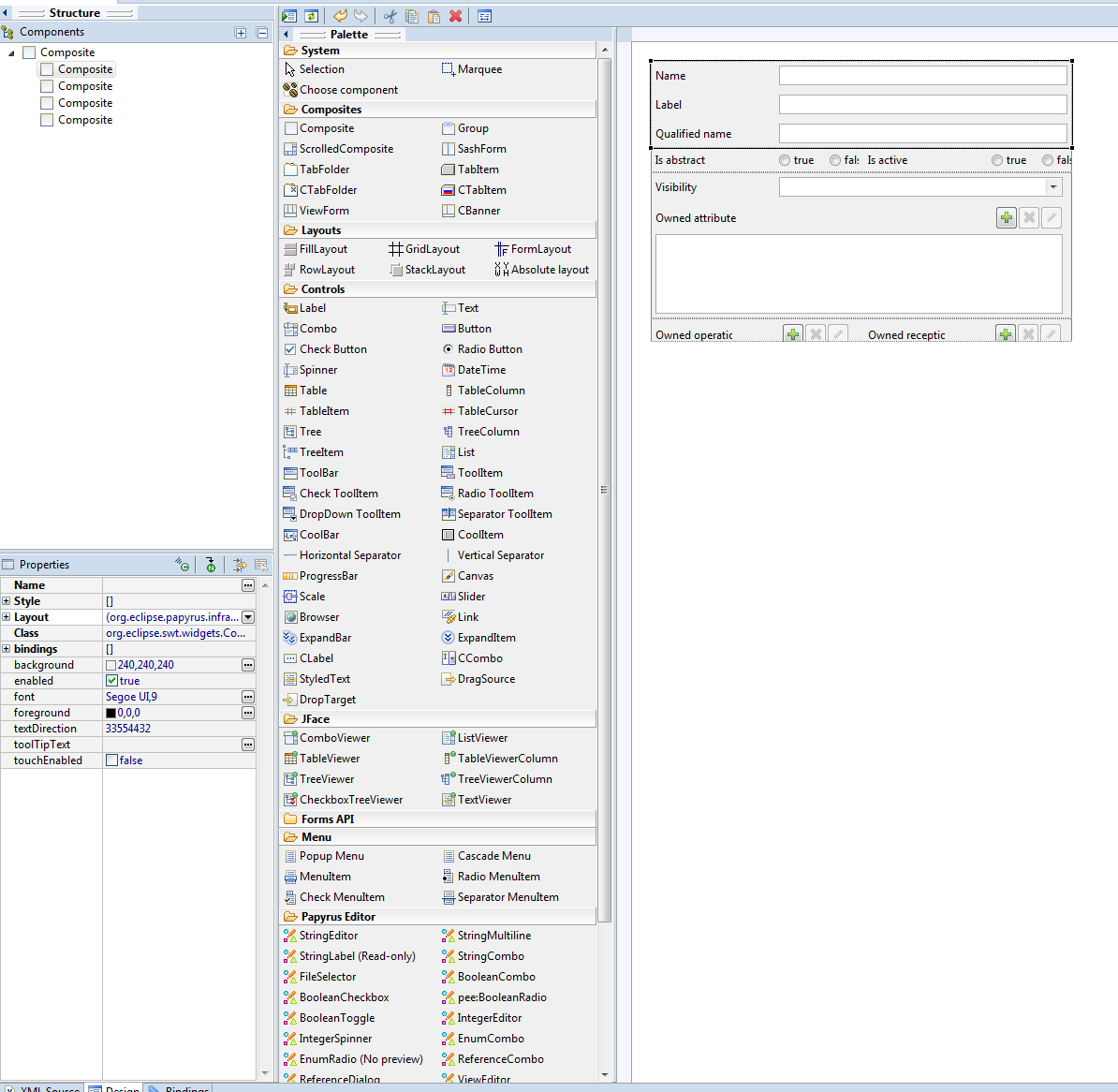

Hello everybody,
I'm working on the integration of Papyrus Properties View framework with WindowBuilder. These views are described with XWT, but with custom widget.
I succeed to render your exising property view with WindowBuilder (hacking it to bypass a ClassLoader problem and continue to work, I just add to windowbuilder a dependency on Papyrus ).
I succeed to add our widgets in the palette using the wb extension point, but I don't understand how to make work it :
- creation is not allowed
- widget can't be selected in the UI. WindowBuilder only understand the composite object.
Our widgets are not instance of Composite, they wrap it and provide a method to create it.
Please do you have some ideas about the process to follow to :
- get my widget selectable in the wb UI
- allow to creation
Here an example of your xwt file:

Since 2 days I continued on my problem. I created :
  • java class "*ComponentInfo" extending org.eclipse.wb.internal.xwt.model.widgets.ControlInfo
  • *.wbp-component.xml file, in which I register my java class as <x-model> and I added <parameter name="XWT.hasModel">true</parameter>
    Now I get ClassCastException because my editors can't be cast as Control.
    Of course I could duplicate and adapt the ControlInfo class to fix by problem, but I would like to know if there is another way for that ? I already tried to add this king od thing in my component.xml file, but without success
    		<parameter name="viewer.control.method" value="getControl" />
    		<parameter name="Wrapper.method">getControl</parameter>
