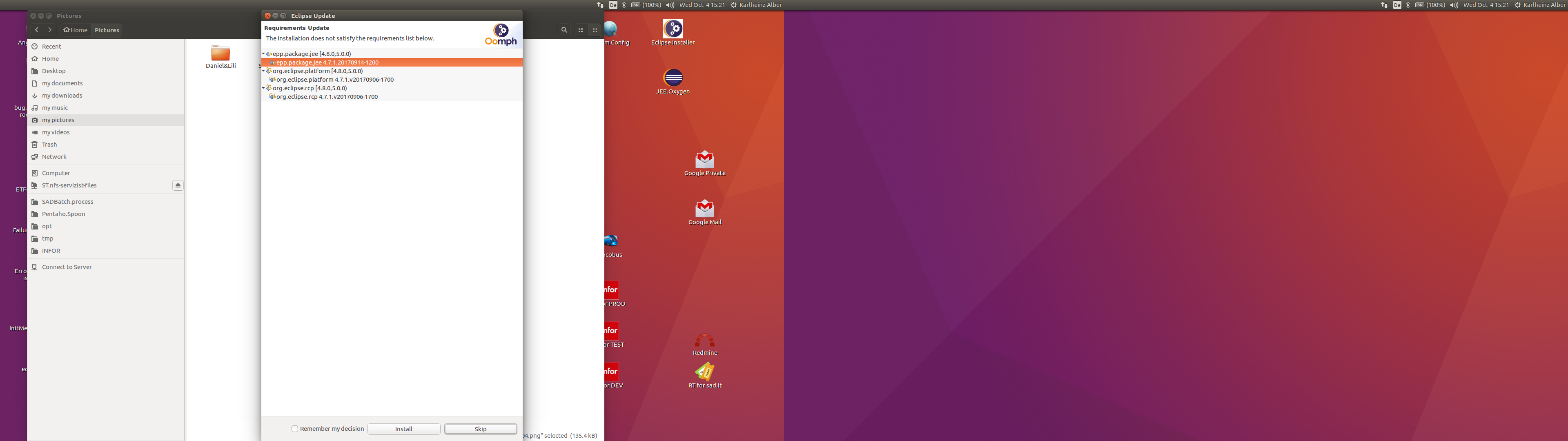

Starting eclipse pops up update screen
asking to update to 4.8 in first line in second line is 4.7.1 xxxx.
Is this an upgrade to 4.8 or only and update of 4.7.1 xxxx ?

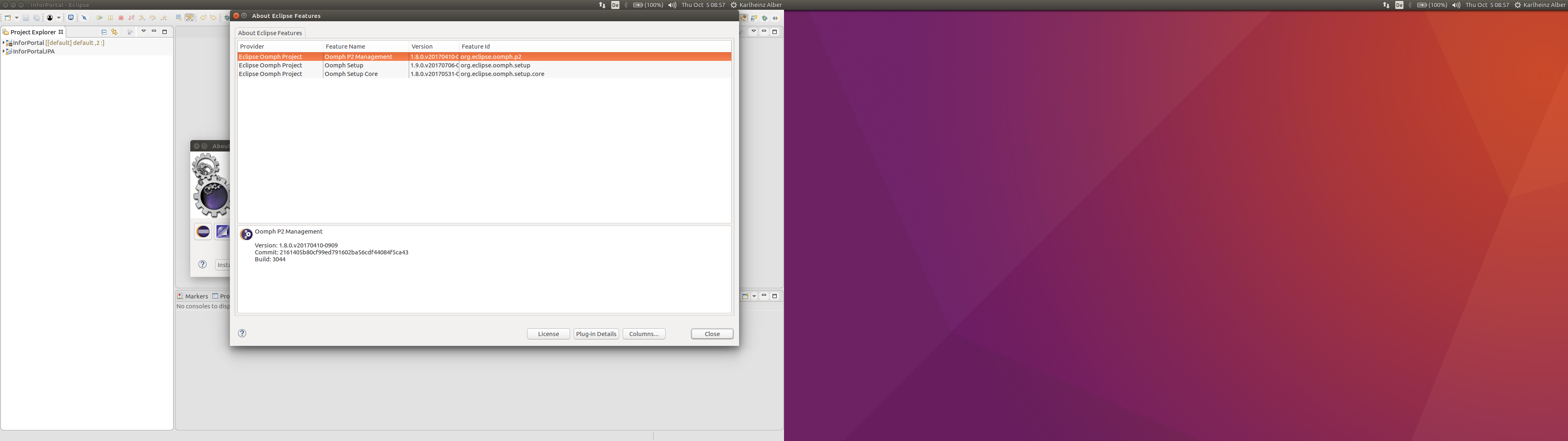

How can i downgrade installer ( oompth ) to Oxygen in Eclipse ?
Going to 'About Eclipse Features' i see it's installed 1.8.
