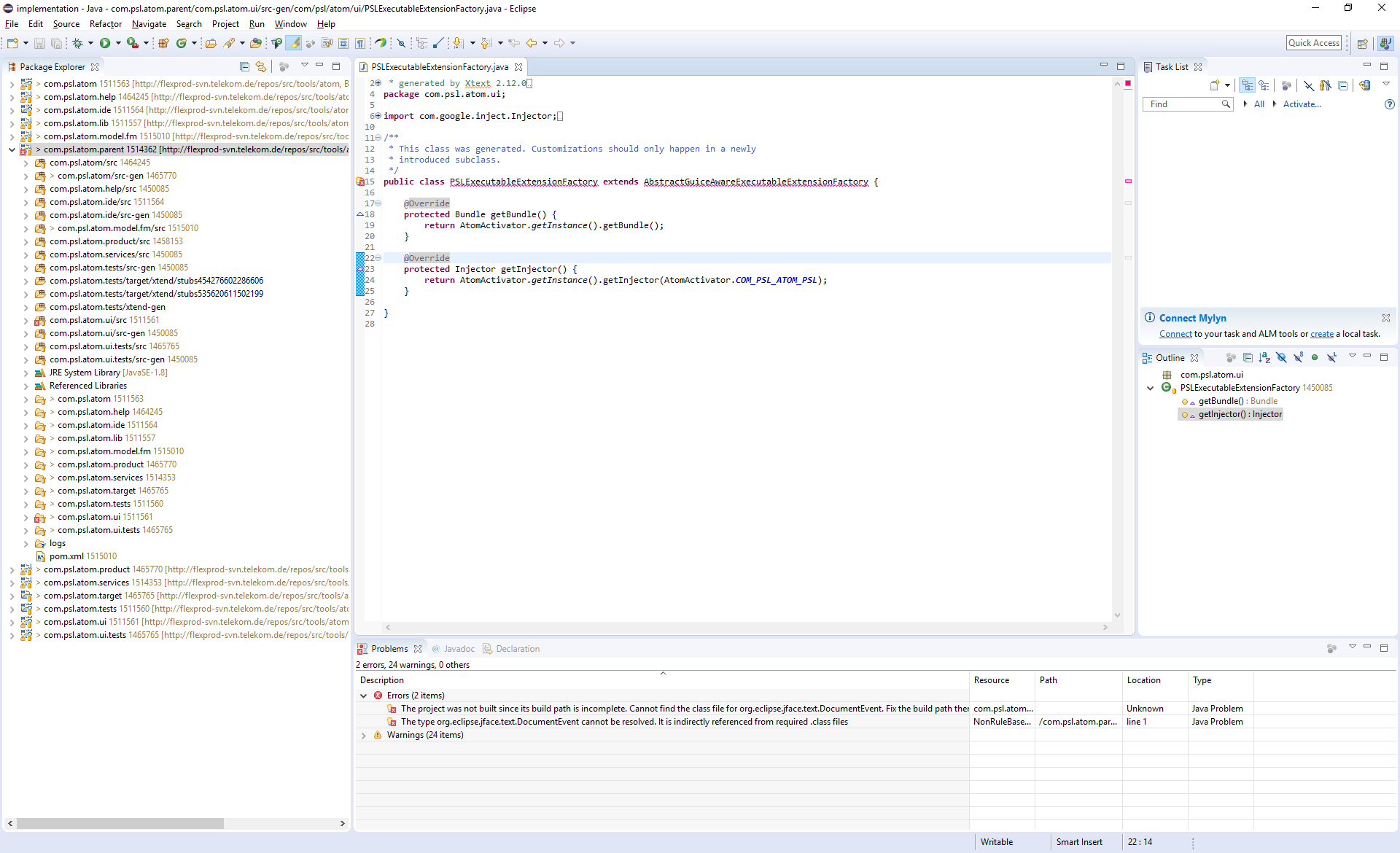

Re: IGrammarAccess cannot be resolved. It is indirectly access [message #1773648 is a reply to message #1773647] Mon, 02 October 2017 07:10 Go to previous messageGo to next message
screenshot has been attached
  • Attachment: eclipse.png
    (Size: 163.32KB, Downloaded 96 times)
Re: IGrammarAccess cannot be resolved. It is indirectly access [message #1773650 is a reply to message #1773648] Mon, 02 October 2017 07:27 Go to previous messageGo to next message
this parent project makes no sense. it should not have any source folders at all.
maybe you have a broken classpath file checked in

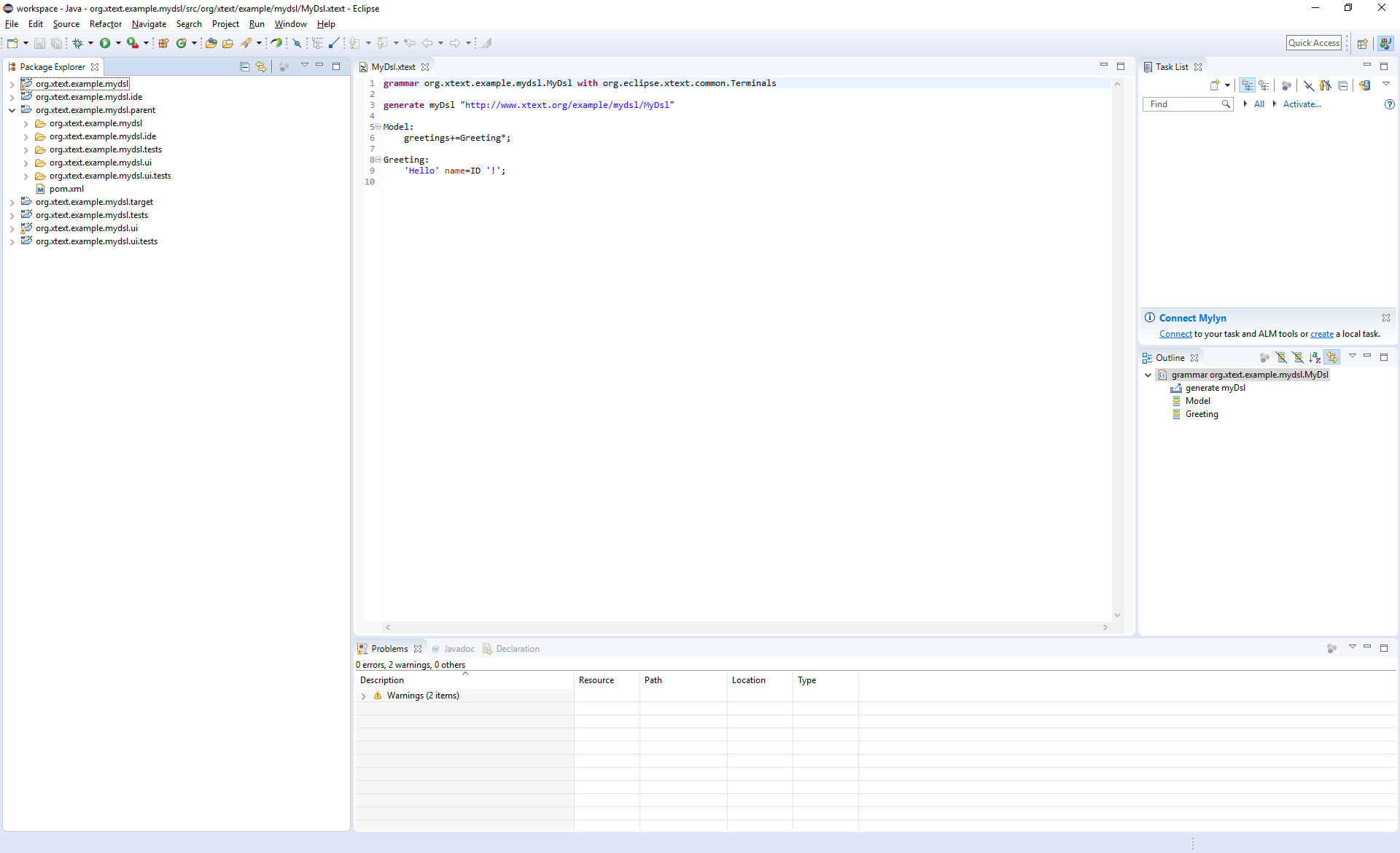

Re: IGrammarAccess cannot be resolved. It is indirectly access [message #1773653 is a reply to message #1773652] Mon, 02 October 2017 07:57 Go to previous messageGo to next message
I tried to create new empty project with xtext wizard. The wizard created .project file and pom.xml in parent folder, but did not create .classpath file. You wrote that .project file should not exists. May be you mean .classpath file should not exists?
  • Attachment: mydsl.png
    (Size: 83.84KB, Downloaded 92 times)
[Updated on: Mon, 02 October 2017 08:00] by Moderator
Re: IGrammarAccess cannot be resolved. It is indirectly access [message #1773654 is a reply to message #1773653] Mon, 02 October 2017 08:12 Go to previous messageGo to next message
no w wrote i should not conain java & xtext nature nor their builders
Re: IGrammarAccess cannot be resolved. It is indirectly access [message #1773655 is a reply to message #1773654] Mon, 02 October 2017 08:24 Go to previous message
in my parent folder there was .classpath file that was generated by EMF while it created code of new model for my project due to an error in configuration. I removed this file. Problem is not observed
